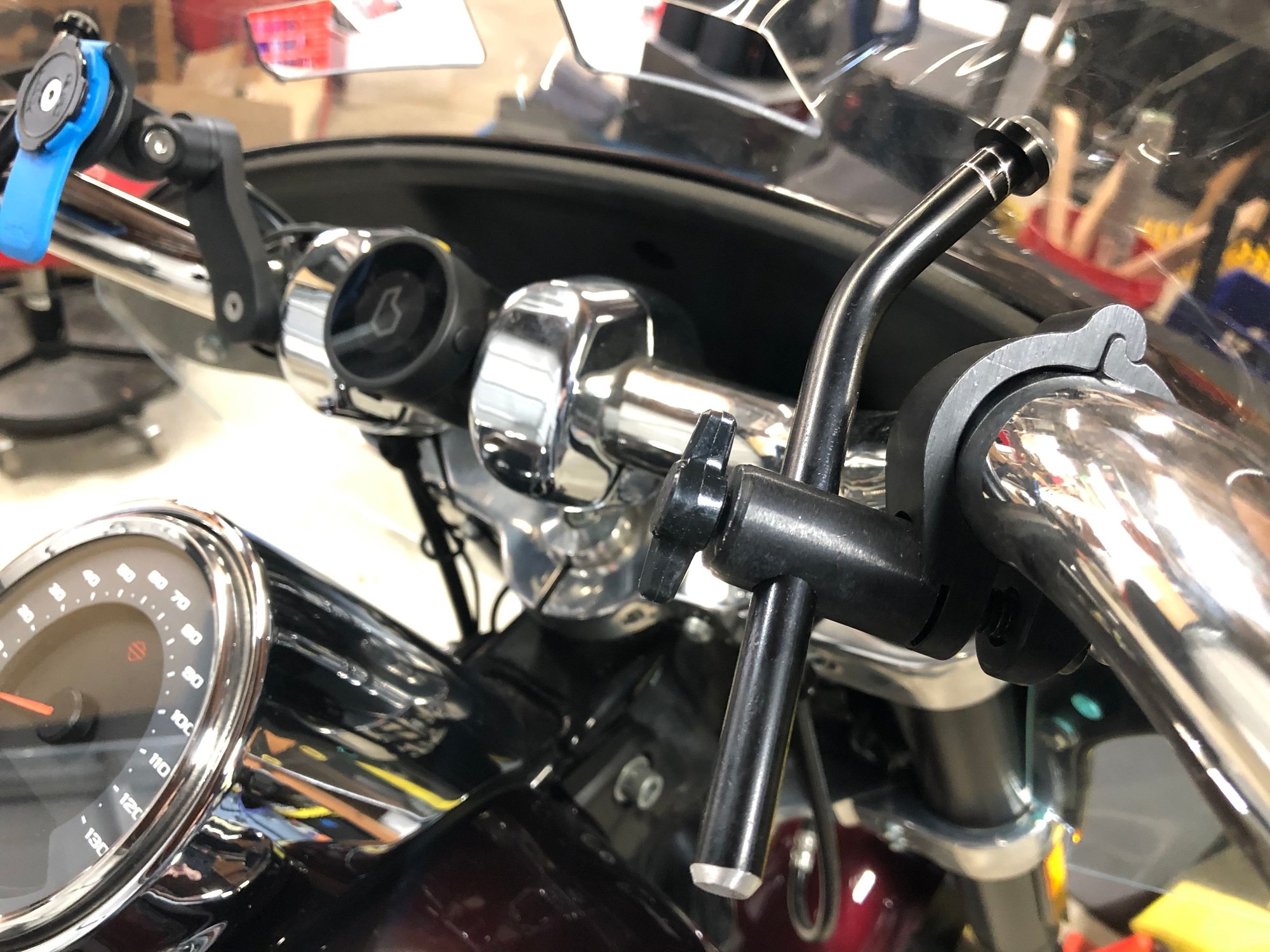

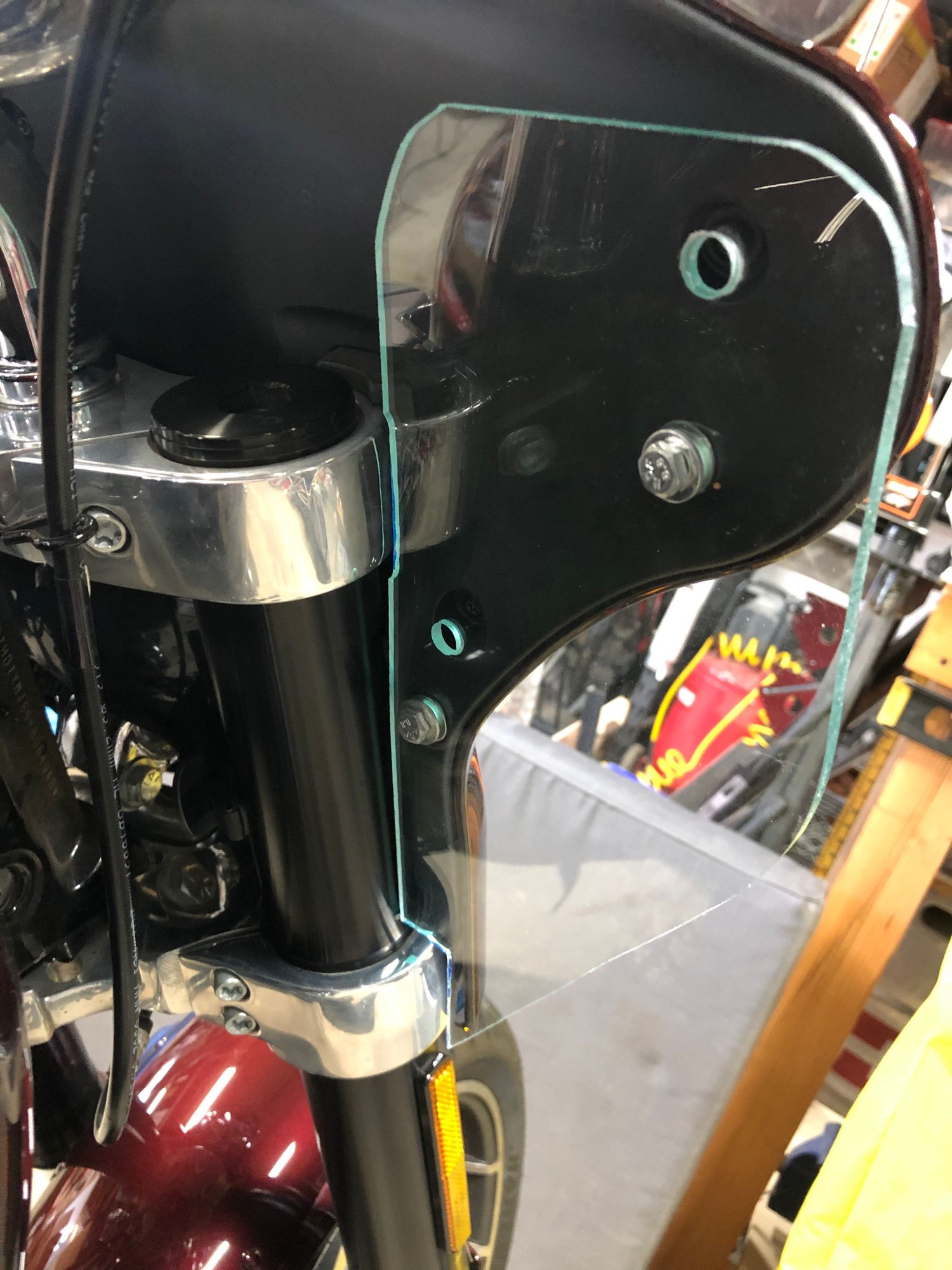

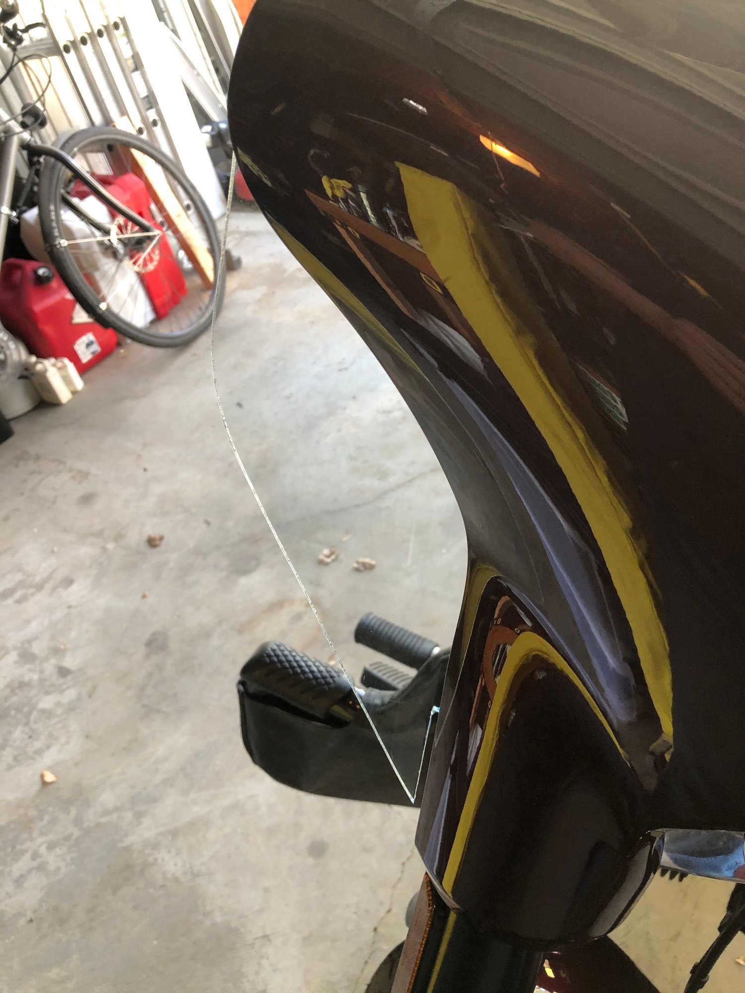

I've done a few things to my Sport Glide. But most recently I've been messing with the front windscreen and making some wind deflectors.
I bought a banged up fairing off someone on here and I've been doing some tinkering.
Setup:
- Windscreen - Gustaffson 15" touring
- Braces - Slip Streamer Tombstone mount (hacked)
- Wind Deflectors - 1/4" acrylic hand cut DIY
The braces I hacked up a set of Slip Stream braces. I don't have the alignment quite right yet and thought I could get away with just some rubber pads. After a 200 mile ride the pad almost slid completely off because of alignment issues.
Wind deflectors I traced out with cardboard (like someone else here did) then cut using a jigsaw.

Will do. Deflectors worked great for the 400 ish miles I have on them! Braces, mostly worked. I think I'm going to design and print up some with my 3d printer.
