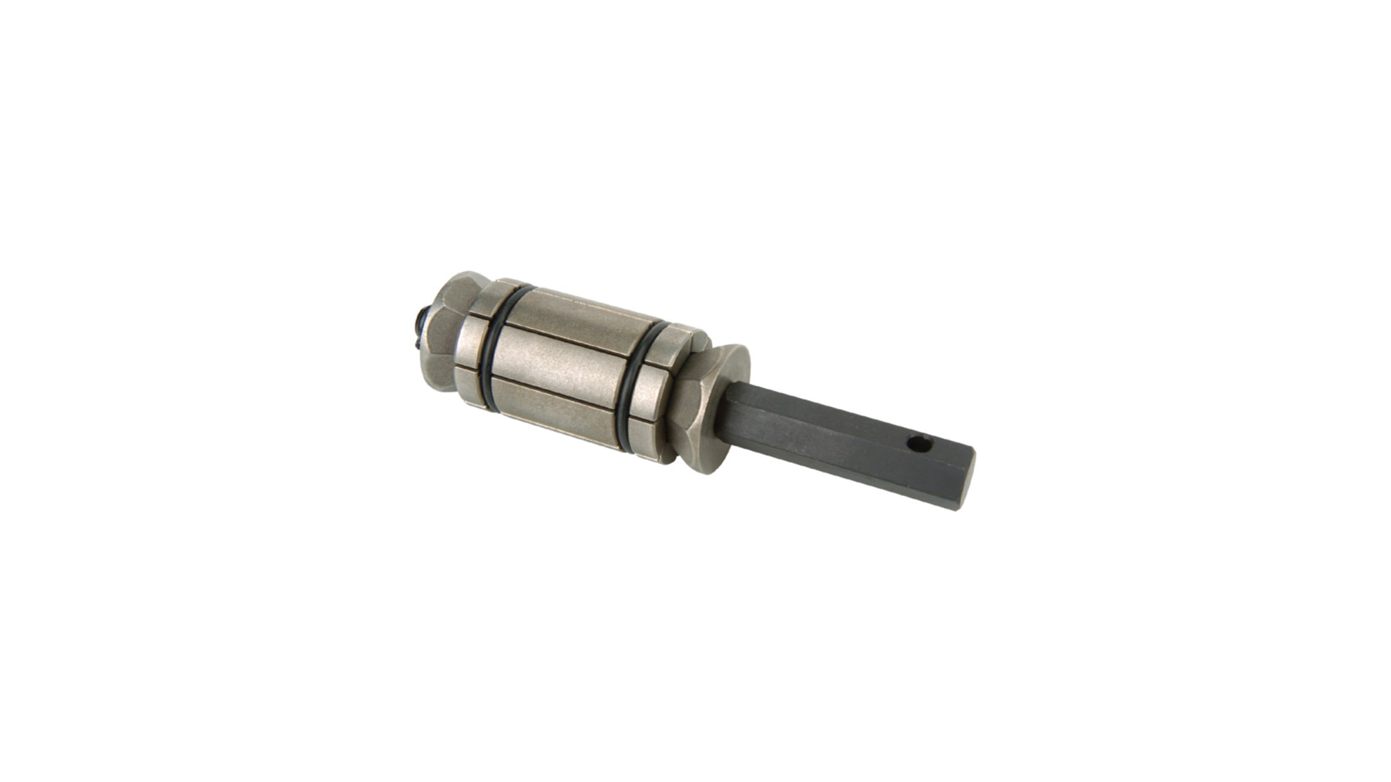

Originally Posted by Ihasabike
Dit is important to insert the gasket far enough to seal the slots. Otherwise, you get an exhaust leak. I had to use a rubber mallet to get mine in far enough after the dealer didn’t get it right.
Use an expander to size the muffers so the seal slips in. Especially if the pipes have been crushed some by the clamps. I bought one at a NAPA store.
