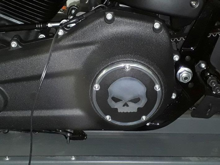

Yep the hole is plugged, HD delivers a plug with the kit witch I did not used because it was a stupid looking chrome thing that was odd looking and to small, so I made my own. There is no oil that can get out,
the other way around is more difficult, a forward control bike to mid controls then you need to change the primary covers but again no need to buy new parts, they can be altered to accept the mids.

Here you see the plugged hole with the plug I made out of aluminium, in real life it is even better then on the picture, you hardly notice it.
