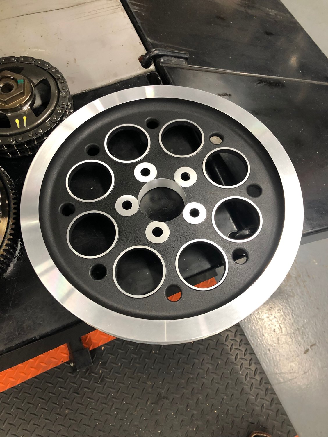

Did you need to machine the hub face or just the pulley rim and teeth?
Just the rim/teeth. Mounting face and everything was fine. Was less than 5 minutes on the lathe.

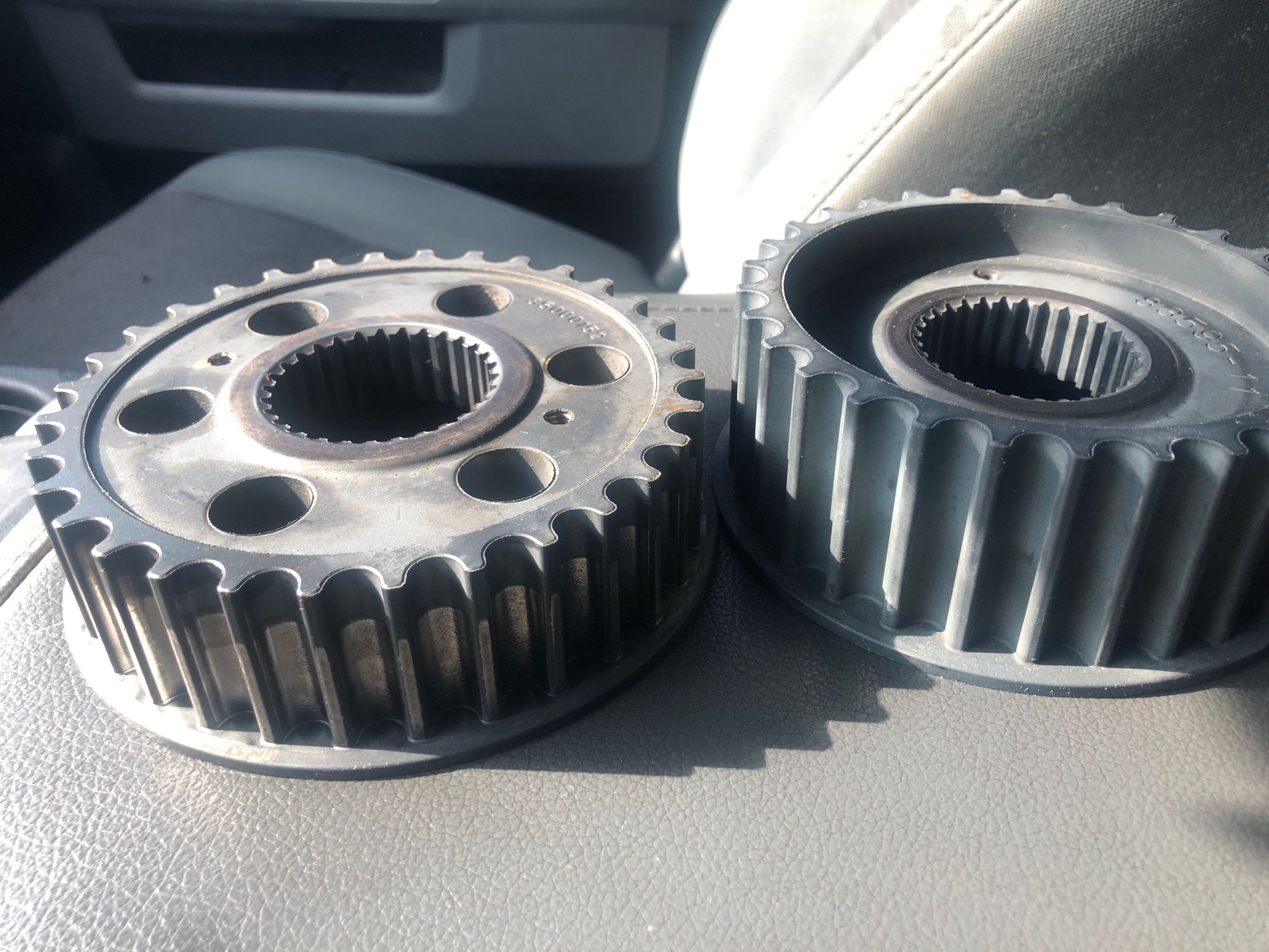

Dropped my machined down 30 tooth sprocket at the dealership today. Even being smaller in diameter and machined down to the same width it was still noticeably heavier than the stock 32. The stock 32 has weight removed with the 6 holes. I would be afraid to drill holes in the 30 tooth though for fear of stress crack or imbalance. Thoughts? Also got to see my 70 tooth pulley while at the dealership. Still hoping to get this thing together and get my break in miles done in early December so I can get the dyno done yet this winter. Plan is to deliver an Airstream TT to southern Florida, Gulf coast or Tucson AZ take her off the bed of my truck and get my break in miles done. Fingers crossed for some good weather.
I did notice that, quite a bit heavier. I think if you had holes drilled at equal distances around it wouldn't throw it out of balance. I am unsure about if it would weaken it at all.
