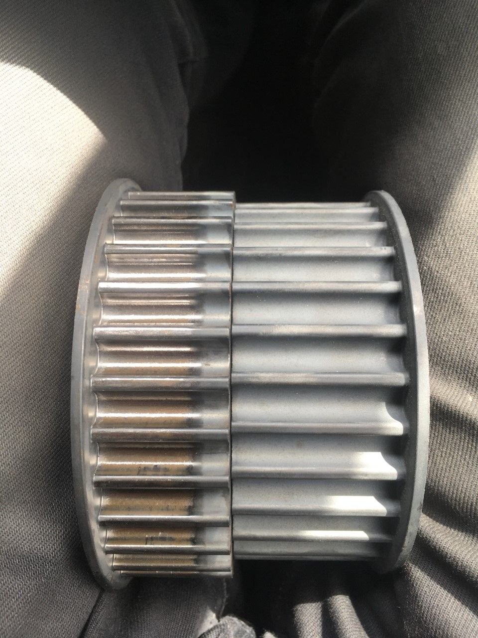

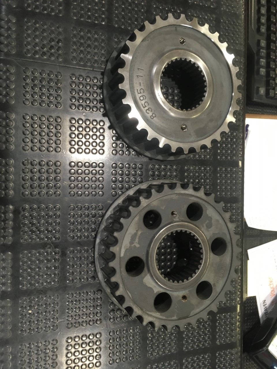

Can confirm, 30T pulley is almost exactly 1/2" wider than the standard 32T pulley on my M8 Softail. Quickly had it skimmed down. mounting it up now.

Did you need to machine the hub face or just the pulley rim and teeth?
