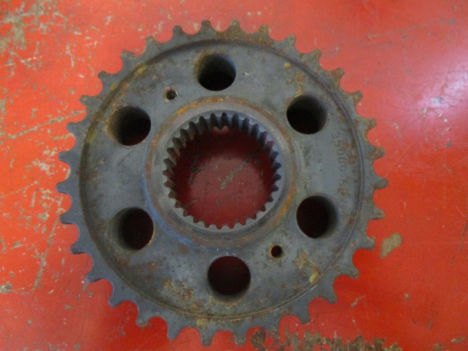

Here is a pic of the prior softail 32T sprocket 40659-06, the new Softail 32T sprocket 35000152, and the newest 30T Trike sprocket 83595-11. Zoom/scale them to match the span across the bolt holes (I used 3 5/16"). Then measure the spline diameter along the same line. They all have 30T splines and they all measure the same. Again, I can't find the problem you're having.
There are older 30T sportster sprockets that won't work.
