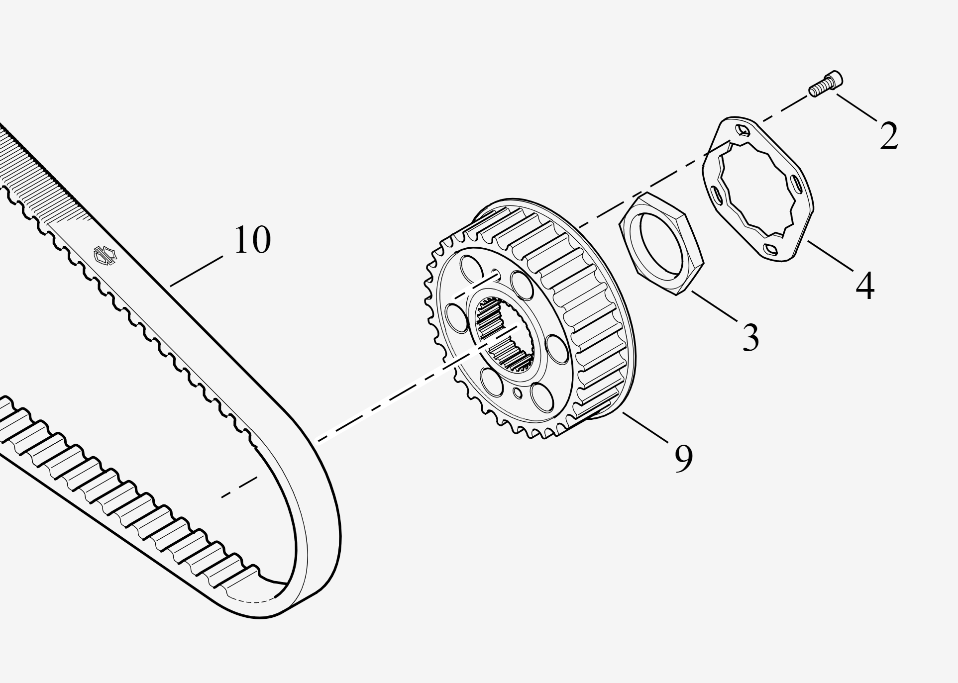

Ok. This may be the answer found on a French web page: https://www.jarrige.fr/harley-davids...re-secondaire/
They say the 30T trike pulley 83595-11 is too wide. Here is a before and after picture of them facing it back in a lathe with the finshed machining next to the M8 stock 32T pulley.
Here you can see how the pulley mounts. There is probably not clearance for that extra wide pulley up against the new Softail transmission case. The Trike transmission case is a different part than the Softail.

Good luck, everything I can find says this 30T pulley mod should work. Based on the pictures below and the parts book, the pulley splines are the same.
