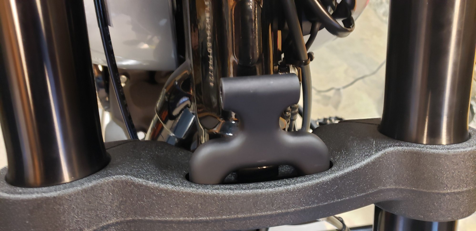

You can see in this picture how the lower mount is intended to go into a single hole on the lower tree. The second picture is the stock LRS headlight mount, you can see it is different and has 2 holes spread apart.

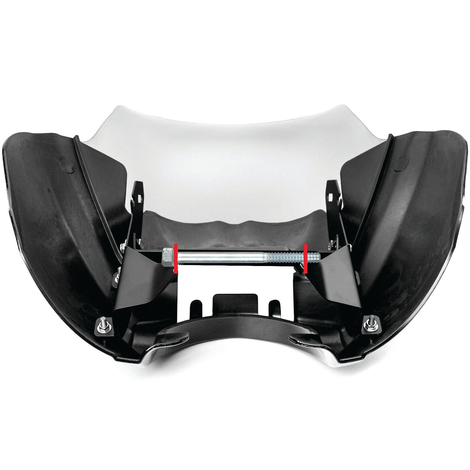

I think for the amazon fairing if you used a longer bolt to mount the headlight with a few extra nuts you could get it to work. In the first pic you would bend the tabs on the fairing mount up like the red lines. Then you run a longer bolt and a few extra nuts like the second pic. The red lines represent where the bent fairing brackets would mount, and the green is where the headlight bracket would mount.
Then you just need to space the headlight out. You could remove the 4 bolts that hold the bracket to the back of it and use some kind of spacer with longer bolts. One guy used longer bolts with some nuts there for the spacing. I printed a spacer for another guy, just waiting to hear the result.
Sorry about the crappy photoshop, but hopefully you get the idea.

that helps out big time. Seriously thank you. I just need to see one in person and I think I can figure it out, with that picture you gave me. 🤙🏼

The krator fairing fits easy. Get a pair .. of sheet metal vise grips, grab the mounting tabs and bend them, then run a bolt w spacers. The Memphis shades headlight relocation thing makes it fit damn near perfect!
