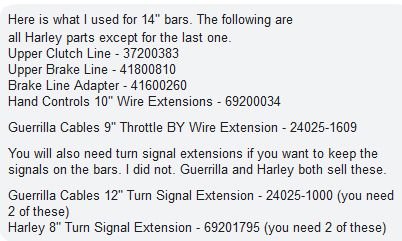

Hello All, i am looking for some input from any of you that have installed the Lucky Daves Lucky 13's in 13" to your bike. I am looking for a list of parts needed to do the swap (Upper clutch cable, Upper brake line, Brake line adapter, wire harness extensions, blinker extensions and TBW extension) Any help would be greatly appreciated.

Have you tried your local dealer? Mine has a parts book that shows the part numbers you need. And they can even order them for you! :-) When I put 12" T bars on my first M8 low rider I needed +4" brake and clutch lines, and the standard wiring extensions also sold by the dealer. There was enough slack with the +4's that 13" bars wouldn't have been any problem.
There are also aftermarket options, but I wanted to stick with HD parts.
the dealer up here in Northern Minnesota have never put a set of the lucky daves on. They want me to put the bars on and bring it to them to measure what lengths i would need. I want to stick with OE parts as well. Just figured if i could bypass all the BS and get some input from folks that have done this already if at all. I plan on ordering the bars soon just trying to get ahead of the game.

This is what I used for 14" bars, should be close enough with 13's to be ok.
awesome thank you very much!
