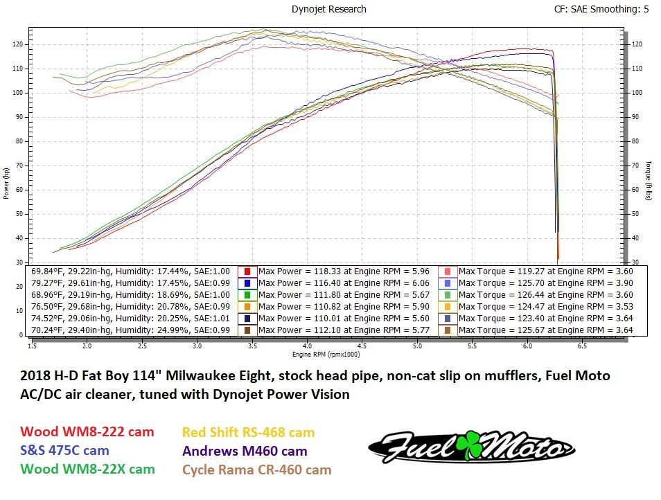

You will not keep warranty with any cam other than the SE ones.The 468 is a stronger left side cam than the 22X, if you go a RS468 make sure they take their time tuning the off idle throttle response.
Apparently the new TTS175 has a nice lumpy idle.
Peace.
I think when you refer to it being a left side cam you are talking about low rpm? I don't see the 468 performing better than the 22x at any part of the curve on Fuel Motos Softail M8 114 test? It actually looks like the 22x has the advantage slightly in the lower rpms from their chart.

Here's the newest cam from Cycle Rama:
I would like to see a chart with that cam in a 114 with an exhaust.

I would like to see the chart for a CR-482 in a 114 as well. I am leaning towards the CR-480 at the moment.
I would like to see more testing on Softails with the exhaust systems WE are using, not the ones all done on the touring bikes. A 900# bike has different cam needs.
Me too. The only chart I have seen with my same pipe (S&S Superstreet) and a CR-480 in a 114 is FLS103's FXFBS chart on here and Sheffer's facebook page.
https://www.hdforums.com/forum/2018-...-thoughts.html
The pipe performs well with the CR480 so I'm thinking it will play well with other cams as well. I would like to see more testing done as well to confirm that.
I'm just happy someone took the time to compare the different cams in a controlled way rather than trying to compare one guys dyno sheet in Florida vs another guy in California.

Fuel Moto suggested the a more torque focused cam with the short 2:1 pipe that I am using. That is what led me to my choice. I went the opposite cam wise on my last bike, which was a Twin Cam.
