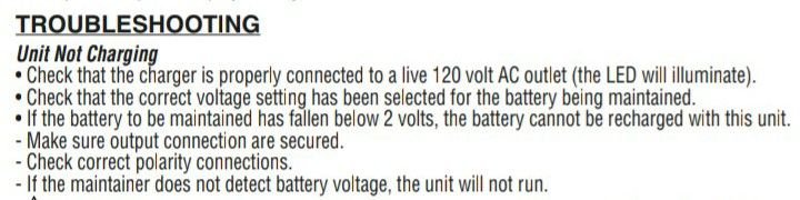

It all depends on the tender. My Deltran Battery Tender Junior will not charge a battery that has less than 3V. The OP's bike sat for 2 months with the lights on. My guess would be the battery was totally discharged.

If you meant Black & Decker, their tenders have a similar feature, although the threshold is 2V.

A digital maintenance tender will only put out when it detects voltage and load. So technically, above is correct that it won't charge a dead battery. A discharged battery is around 12.1 or so. A battery that reads 3 volts or lower is not going back in my Harley with a $400. parts alone charging system.
It's so sulfated at 3 volts, it may come back but it is severely damaged. My last Harley gel mat battery said on it to not charge it with regular charger. However, I am sure there sre some quality chargers that can throw out 12 AMP and meter back to 12.6. Would think that would be OK.
I assume that is what our small maintenance chargers do. However I have noticed my even after days still reads more the 12.6 when I remove it. Battery only drops back to normal if I flip lights on and off or let it set a few hours.
​​​​I personally take mine off charger when Ieave it for months. Modern Harley's taper off even with alarm set and won't hurt a fully charged good battery. The Speedometer, ECM, Alarm and Remote System only draw in the mili amps . Mine will start after 3-4 months.

Yes this is Black & Decker the exact same one so I was wrong. I also dont leave my battery on tender just occasional charge to top it off and never had and issues.
