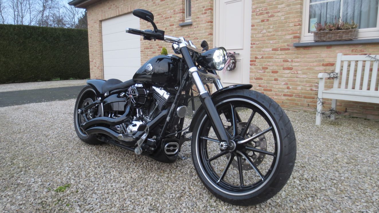

You can powder coat over chrome without removing the chrome, just sandblasted, done that several times and also my heatshields are powder coated for over 3 years now, the exhaust itself I would not recommend but the heatshields is no prob.
Also if you want to remove the chrome that is no rocket science and can be done at home , I prefer outside do . I go even further than that, you can even reuse the chrome again to put on something els if you want. It can be done with a battery
charger and some household products. I have the list here if interested and there is plenty of info on YT.
