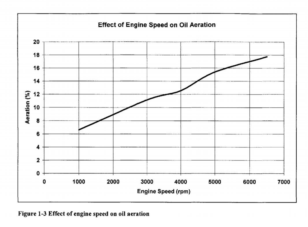

It is not simply thermal expansion. There is entrainment of air into the oil when the engine is running.
Here's a chart showing typical volume increase due to aeration from a paper titled "Engine Lubrication Oil Aeration".
