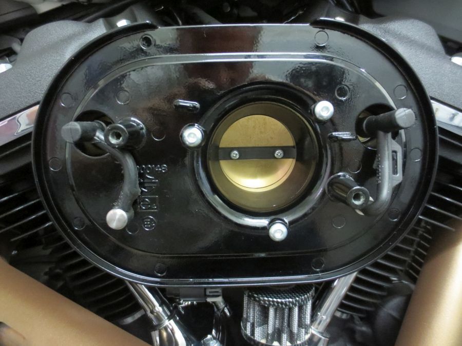

Well, the DK EBS will not fit inside the Ventilator AC. Its diameter is too big. Next try will be to check into a T that has a means of passing through a hole in the backing plate and fastening to it. I figure if I can get the "right" size hardware I'll be able to use a rubber plug on the hole when needed, while quickly removing the external system.

I've got it all plumbed, though I do have some fuel line clamps coming to go over the hoses on the breather bolts to replace the green ones that are on it now. I don't expect these would come off but I won't ride it until I have the better clamps on it, as these don't slide in far enough to be completely on the inboard side of the bulbs on the nozzle ends. I know the other ends of the hoses won't come off so the clamps there are fine.
I'm hoping that this will take care of things, assuming my bike is not pushing out too much blow-by. If it is, and the can fills up to quickly and/or starts puking oil on the bike I'll take all of this off, plug the 7/16 hole I drilled in the backing plate and bring it to the dealer.
I realize this may affect the airflow somewhat, but I don't plan on any 1/4 mile runs, and the fresh air it will be taking in without oil mist and/or oil may offset any adverse air turbulence. I had a similar setup last year to get the yellow fuel lines deeper into the intake and that didn't affect the performance at all. I ran with these same green clips then but took my airbox apart after each run to check them.

Did both things,
The first was the mod on the breathers on my FXFBS .
And then I made a vented dipstick from a oem plastik that comes with the bike like the FXFBS or FXBB and so on.... , FYI - the Touring dipstick is not the same, that one is threaded !

Originally Posted by iHodor
Did you do both at the same time? How did each work out?
You must have some machining equipment and skills. The dipstick mod you did especially looks good and is something I'd like to be able to do. Did you have to run a long vent hose like Fueling recommends?
Thanks for the pics and info!
Yep I have the skills and machinery, if I can I make the parts myself.
The first thing I did was the breathers and after a year still saw no oil or anything else in the filter that you see below the airfilter, it is so clean as it was new. The dipstick creation was more of showoff that I can
make these parts from the oem stuff with minimum costs and effort . I have a long venthose on it with a filter just like the one from Fuelling, in the dipstick itself sits a one way valve.
