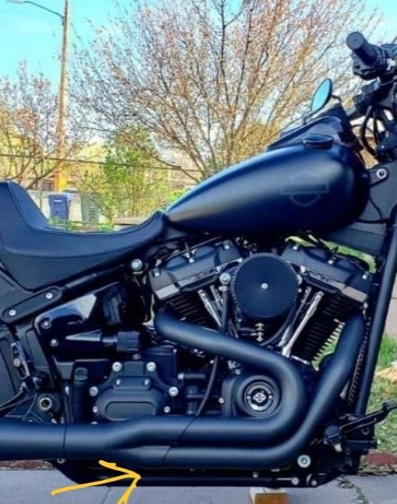

Mine had a filter but I just ran the lines down to a T behind the exhaust headers then ran the single hose down and to and along the bottom frame tube just before it bends back up towards the swing arm pivot point. Sorry I don't have better pictures. I removed this air cleaner and put my stock one back on and haven't modified it to vent externally yet.
