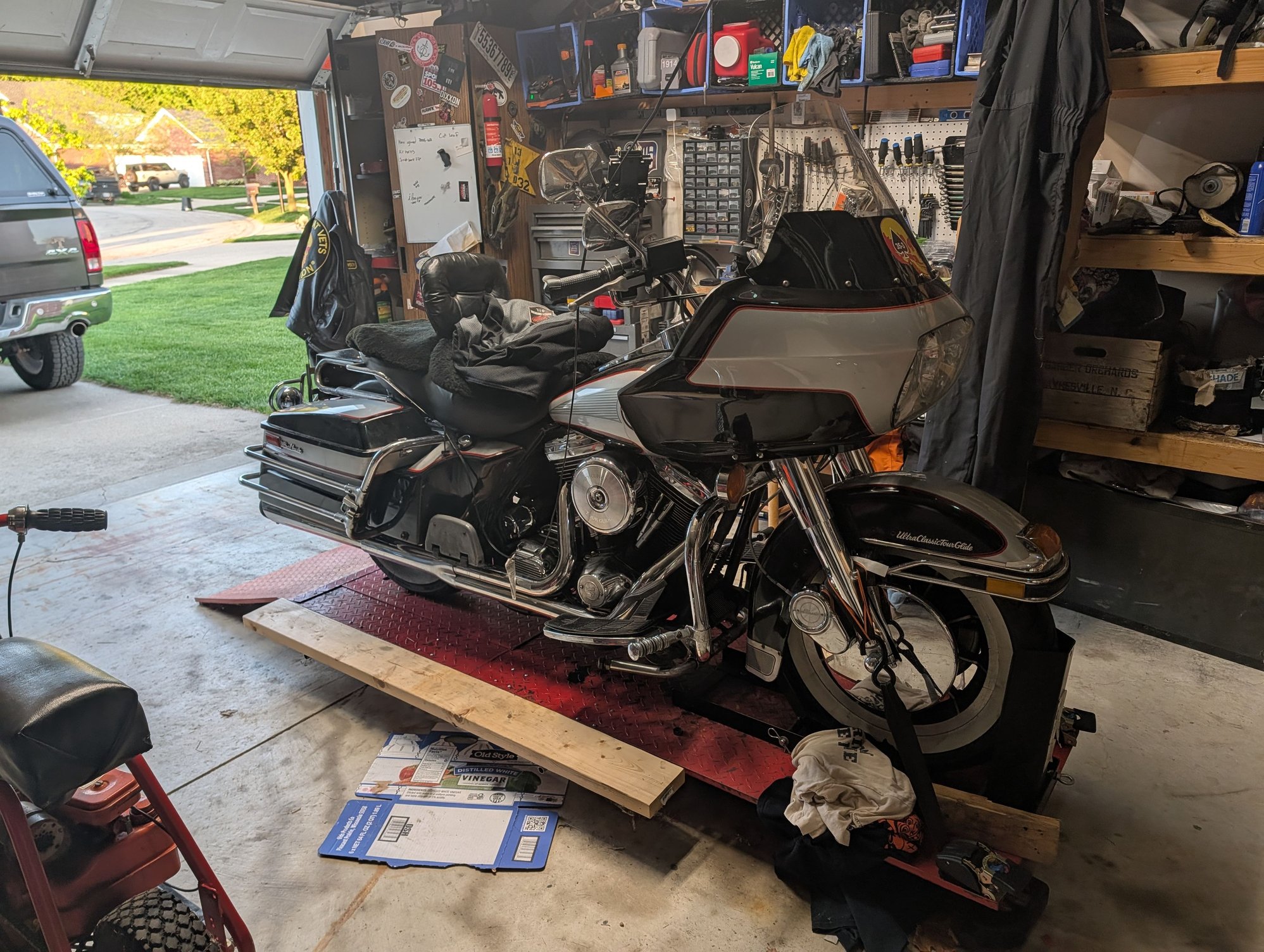

My Tour Glide is just becoming too much of a bike for me. I have put a lot of work into it, so I decided instead of a smaller bike, I would just try to get this one to more like a FLHS, and hopefully that would be enough. It seems pretty straightforward, remove the Tour Pak, lowers and fairing. I already ordered a nacelle from a FLHS, so I just need to find the headlight bucket and light (I think I have one stashed in the garage). If anyone has done this and can think of any tips or things I may miss, I would love to hear them. Bike is a 89 FLTC-U.

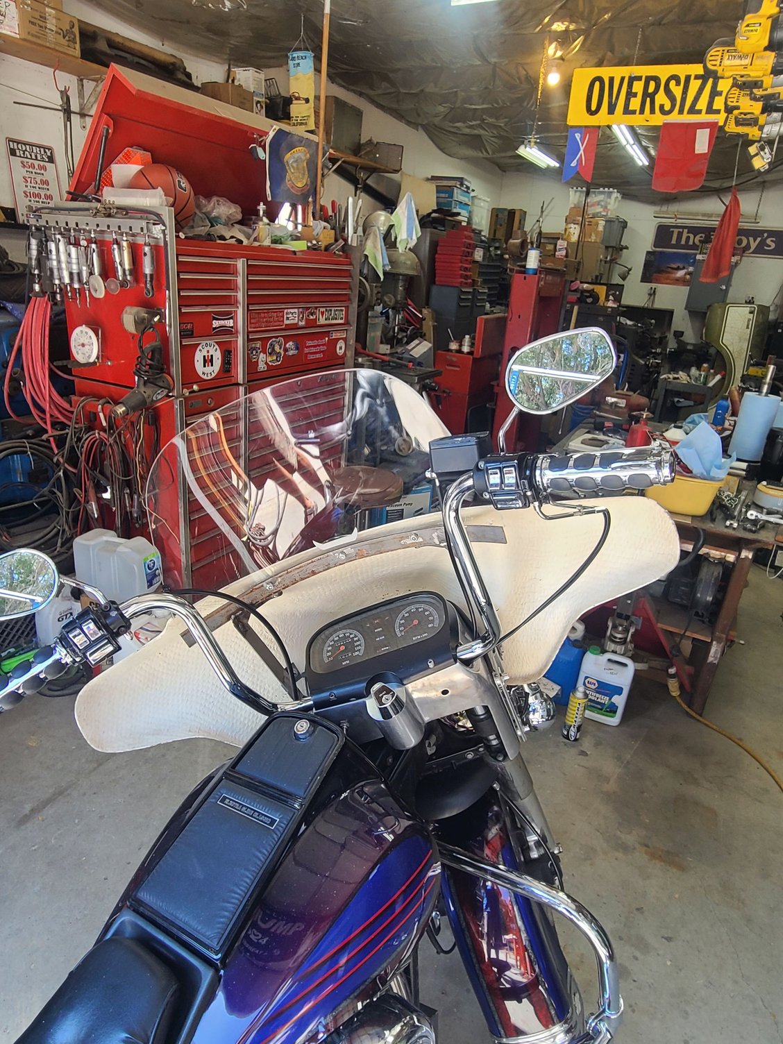

These bikes do look cool without the fairing and all that. The gauge package is different but cool. There's one to the left in this picture. IDK what he used for a headlight.

That headlight on the left is the ABS plastic nacelle that was on the FLHS. I found one on EBay and it's on the way.

The fairing with the gauges and lights are going to be a thing to change out. I would suggest ditching the tour pak and lowers first and see if that lightens her up enough for you. Those bits are easy to remove and weigh more than you might think, especially with your vintage of bike. Good luck.

I got the Tour Pack and lowers off, all I can do until the nacelle and headlight come in. I did realize that I'm also going to need the bar with running lights and turn signals, since my turns are attached to the fairing mount. I'll ride it like this until I get parts and a plan of attack for the front.
