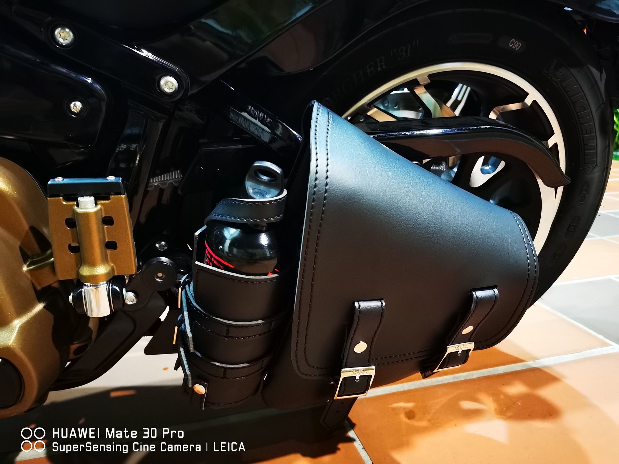

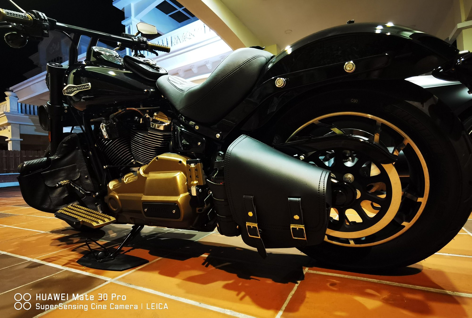

Added a swing arm bag where I put my raincoat and a portable mini air pump. Still have some storage left for other smaller items.
Strapped a toolbox Infront of the fork and I was able to fit in tyre repair kit together with some handy tools.

That tool bag on the forks is gonna ruin your fender.

Front toolbox or the swingarm bag ?
U mean scratches ? Or aesthetically ?
I wasnt sure if it will leave marks on the fork/fender/etc... But I did install a film to protect the paint.

Scratches for sure, maybe dents.

I think when the front forks compress (hitting a bump) the front fender might hit the bottom of the tool bag pretty hard.

Had same issue with my Heritage running a front tool bag. Scuff marks on fender, even when it looks like you have a lot of clearance. If anything heavy in the bag, risk dents.

Alright, good feedback... Maybe the front toolbox might not be viable... Anyone have bad experience on the swing arm bag ? Is it ok to use ?

Fork-mounted toolbag is very classic, but an even bigger concern is blocking airflow to the oil cooler and the engine. Some folks mount the bag to the handlebars which also looks good to me.

Not related to the post but I dig that gold engine casing. Like riding around on a king's throne, powered by the holy gold motor.

That is how I have mine mounted, on the handle bars, also easier to get into it when I need something from it.
