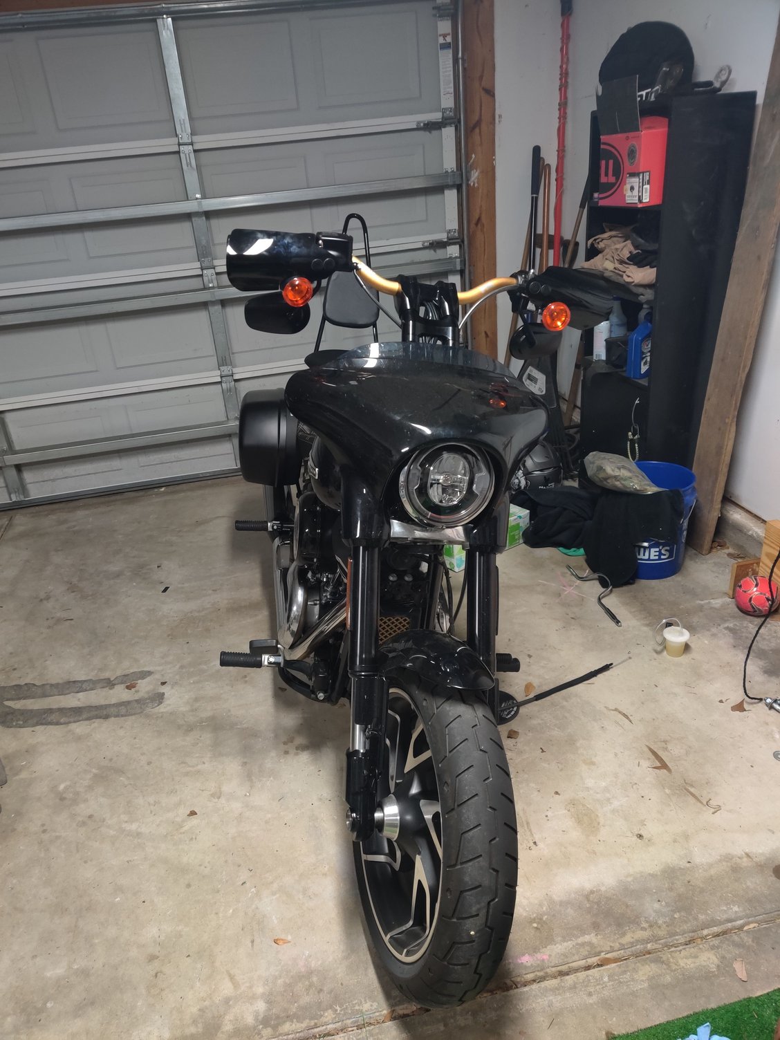

I just installed the Kraus 12 in Kickback risers on my sport glide and you are correct. They are pricey but they are also super high quality. Also most people dont realized that they are modular, you can remove the legs from the riser and purchase a different size from Kraus for >$100. I love them
Yes I am changing my fairing

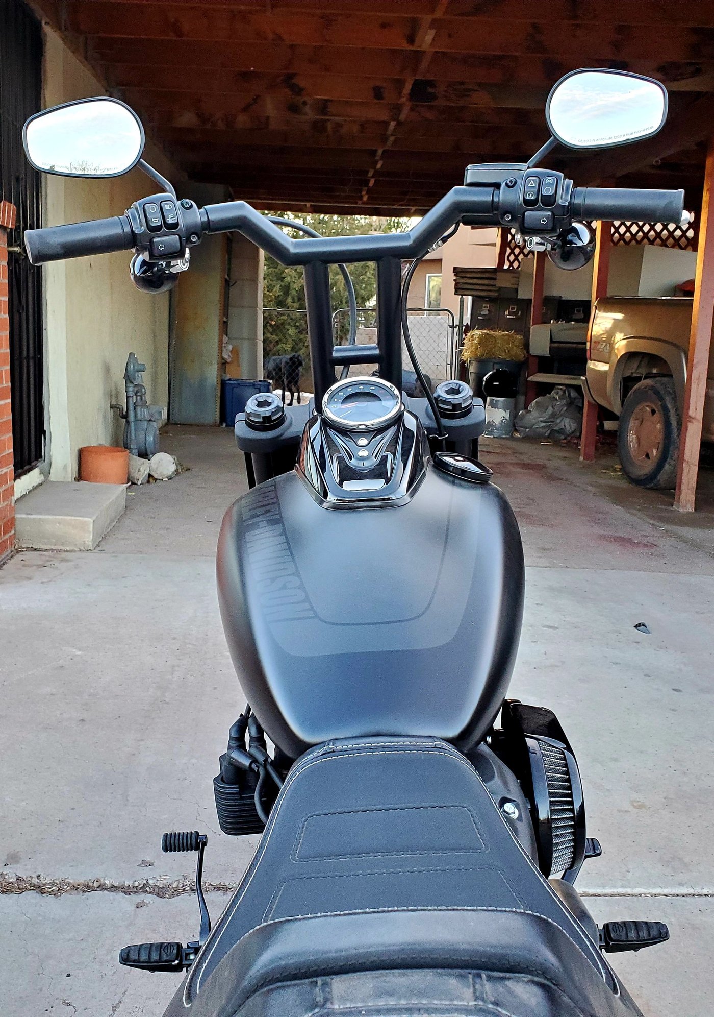

I just installed the Kraus kickback risers and Fly Moto bars on my Fat Bob. You want to use the Fly Moto bars with the Kraus risers because the bars are cut with a hole in the center that match with the hole in the center of the risers. I'm sure you could use another bar if you wanted to but you'd have to drill/mill out a hole in the center of the bar for the wiring to run through. I got the 10" risers because I didn't know exactly how high I wanted to go. I should have gotten the 12". Instead of getting the longer riser legs I bought their Raptor plate. It raised the bars an extra 2" and brought them back another 1.5". Use a 42" upper clutch cable. I got a 32" upper brake line from Magnum Shielding with a 35 degree banjo. With those lengths you'll have plenty of slack.

Part # and details on the brake line.
With the Raptor plate on this is basically a 12" rise and 3" pull back, with a 15" tall wind screen on the road warrior fairing.
The wiring feeds down through the center of the bars through the matching hole in the riser. I cut and soldered the wiring extensions onto the factory wiring because the extra plugs were too bulky and made it look like crap. The 42" clutch cable threads down through the center of the riser.
