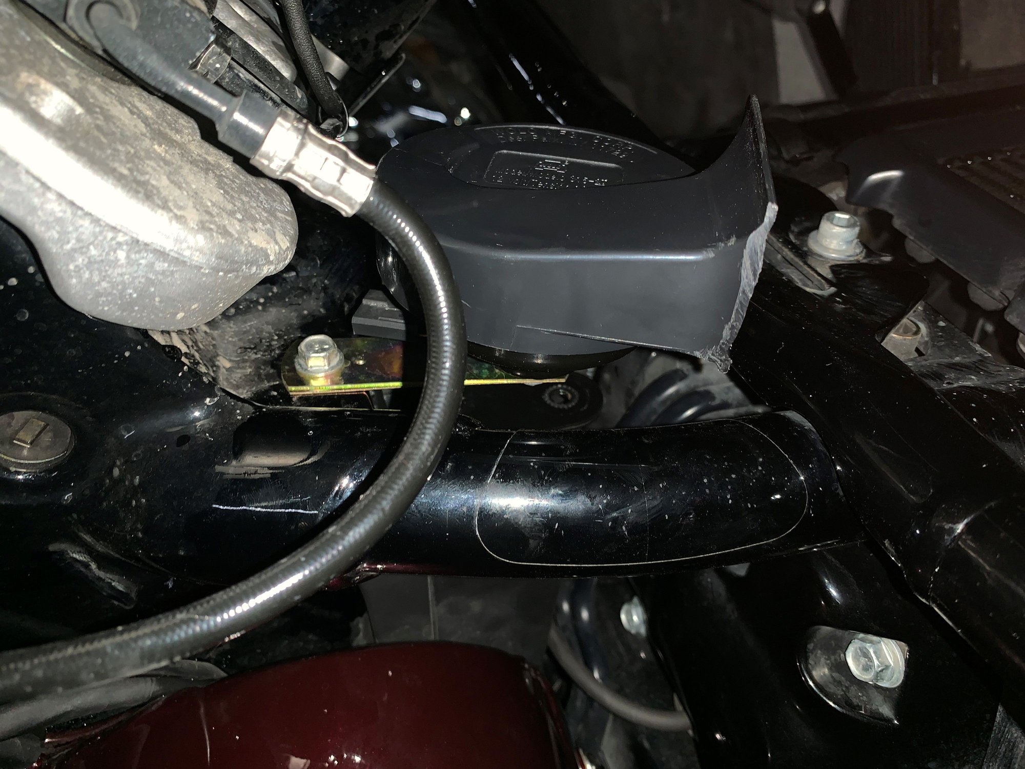

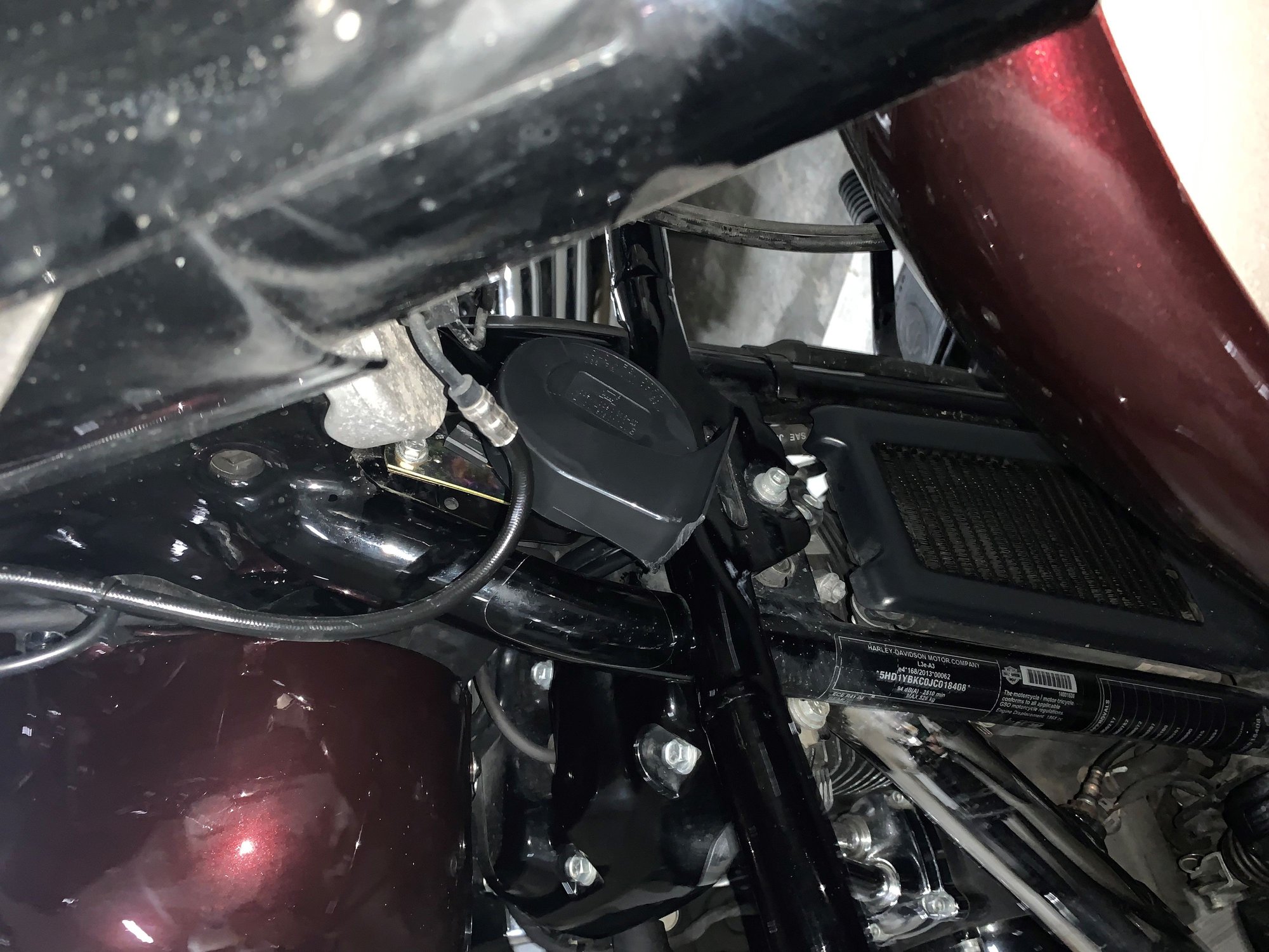

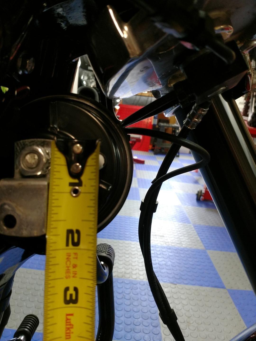

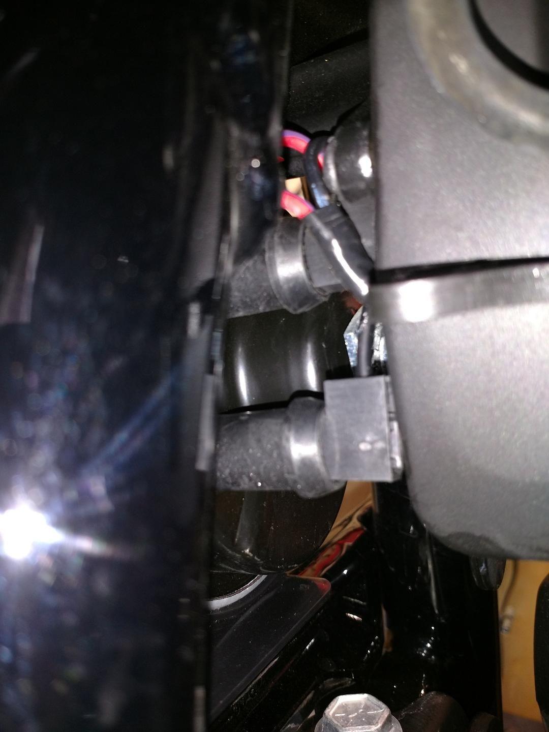

I changed mine to this one and it’s better....hooked right up but I needed to make a small bracket to mount it. The pics aren’t great but you should get the idea
https://www.amazon.com/gp/product/B000CQDRN4/ref=ppx_yo_dt_b_search_asin_title?ie=UTF8&psc=1 https://www.amazon.com/gp/product/B000CQDRN4/ref=ppx_yo_dt_b_search_asin_title?ie=UTF8&psc=1
left side of the bike
right side where you can see the homemade bracket
https://www.amazon.com/gp/product/B0...?ie=UTF8&psc=1
What did you use for the bracket material?
I have a Harley loud horn like yours AND a crash bar I want to mount occasionally that would get in the way.

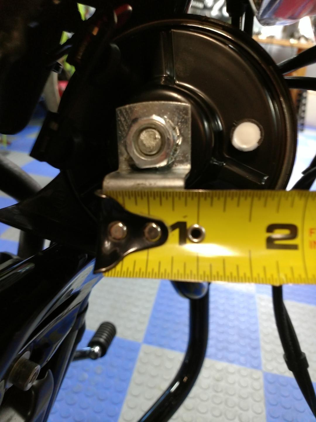

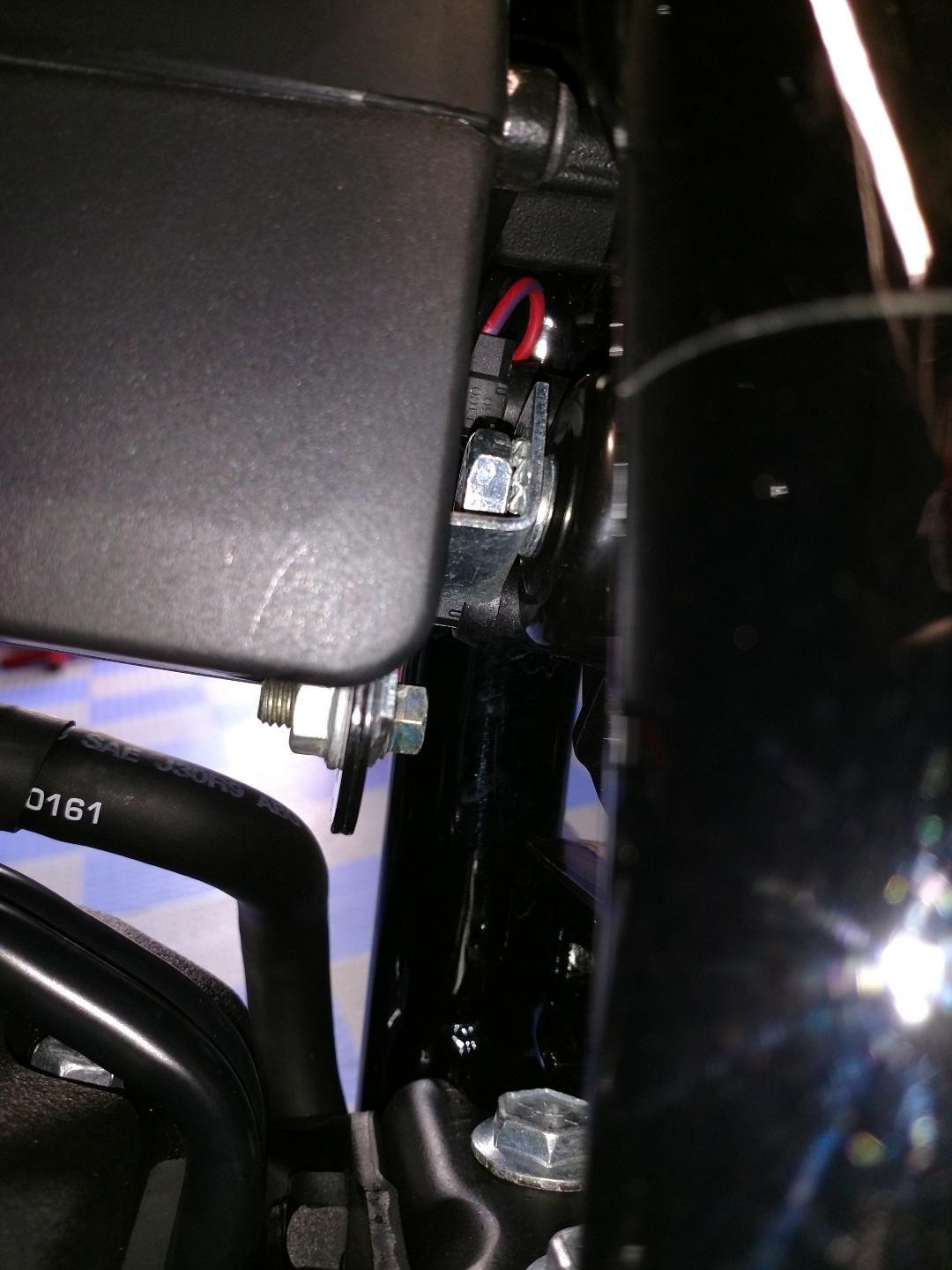

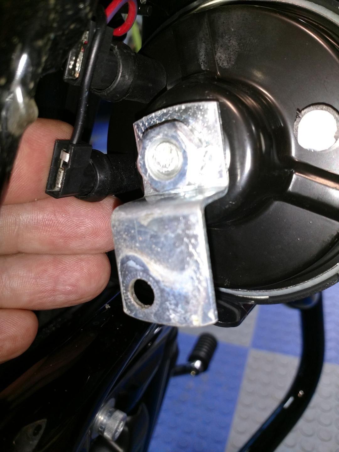

I used a scrap piece of galvanized steel 1/16” thick that I had laying around, I pulled it off my bike to get a couple more photos of it.
Thank you, was wondering how I was going to fit the horn.

Wolo loud horn on Amazon was around $10 and
includes two pieces of scrap metal that you use as a bracket, Plugs right in. Hard part is removing the old horn because some of bolts are pia. May need to trim the new horn plastic a little but no big deal.
