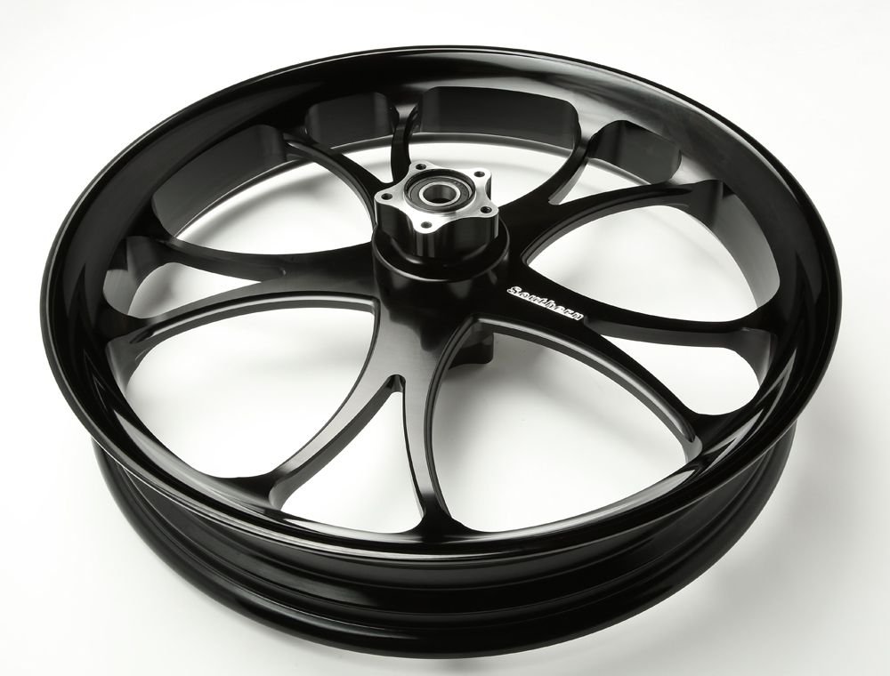

I like tubeless tires and when I saw how much runout my spoked wheels had during a tire change I decided to order new wheels from: Southern Machine
These are fully machined forged aluminum wheels, not castings. The finish is black anodized, not powder coat. For the Heritage I selected 16 x 3.5 wheels. Stock wheels are 16 x 3 which is OK for the front but a little too narrow for the rear in my opinion. I had them shipped mounted with Bridgestone H50 tires in the stock size and ABS bearings installed.
I like the good grip and improved ride that taller profile tires can provide on real-world uneven road surfaces so I did not upsize the wheel diameter. I ride a lot of back roads.
The reflective red strips are from Tape Works.
No more spokes. Now I carry a plug kit from Dynaplug.

The wheels look great ! What did you do and what's the difficulty level/parts needed to set up the brakes, rotors, etc. on the new wheels?
Very nice, tape adds a nice touch! I'm not seeing a choice for my 2020 Low Rider (S) with 19" front. Will have to give them a call, start saving my pennies, I like these wheels.
I don't like the stock wheel design/construction and a ton of wheel weights. They seem cheap. A new machined wheel and good tire like this will probably smooth out the ride too.

You'll still need wheel weights to balance the wheel though, won'tyou? That's caused by imbalance of the tyre.
The wheels are super easy if you order them with bearings and tires installed. Just transfer the stock brake rotors and the rear drive pulley. They go on exactly like the factory wheels.
