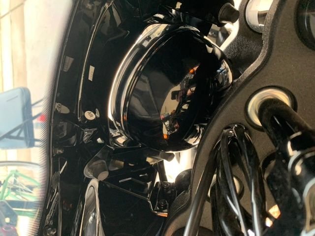

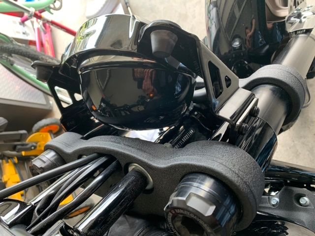

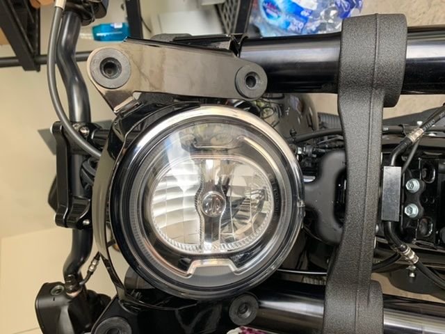

I installed my quarter fairing last week and like most people I did not like the way the headlight fixture was exposed. I saw a thread on the subject but on a whim I took the risk and ordered H-D Headlight Bucket Part #67700455. I pulled out the harness inside the new bucket, pulled the pins on the factory harness and ran them through a new grommet. It worked like a champ to finish the look. All I need to do now is get a black headlamp trim ring and it will be good to go. Too easy and looks way better than before.
With fairing installed.
Without fairing installed.
