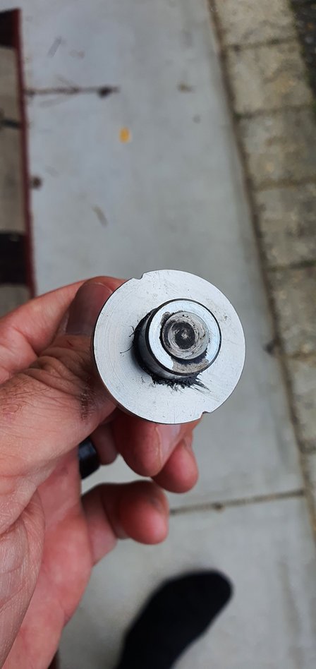

Originally Posted by Cootey
Ok, I've found the issue.
The threaded adjuster "bolt" acts on the hydraulic piston and isn't very well greased from the factory, as suspected.
I dismantled the adjuster further to see this:
i cleaned up the face of the bolt and applied a very heavy grease to the bolt and piston. I reassembled and there you go. Smooth as new!!
To get this apart, you need to back the adjuster completely off, remove the snap ring (make sure the spring for the adjuster clicker is also out) and pull the adjuster assembly out of the housing.
Reassemble the unit making sure the two grooves either side are lined up, and the hole for the clicker spring is at the bottom.
Hope this helps someone in the future 👍🏻👍🏻👍🏻

Originally Posted by wannavee
Resurrecting an old thread.. Could you avoid the snap ring difficulty altogether by just backing the bolt completely out and squirting grease into the bolt hole and then putting the bolt back in never removing the adjuster assembly or is there more to it than just a bolt running through a disc?
Nah, it has a mushroom head on that side so it turns on the piston like a bearing. But its not very well lubricated. I just bought a brand new Sport Glide and it has the same drama already, funny this thread should pop up again!
