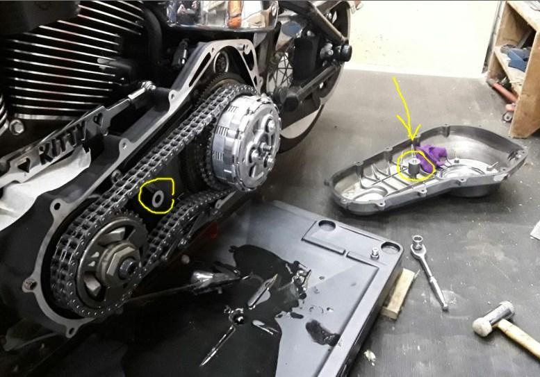

Old Mar 10, 2021 | 06:33 AM
MoneyFor's Avatar
MoneyFor
Joined: Feb 2017
Posts: 2,583
Likes: 1,029
From: East Flanders - Belgium
There is no need to buy a new part for mids, you can drill them true, everything is in place, it just need to be drilled out. Another option would be a swap with someone
that does the opposite going from mids to fronts, if I would live near by your place I would have swapped with you, did this on my FXBB.
