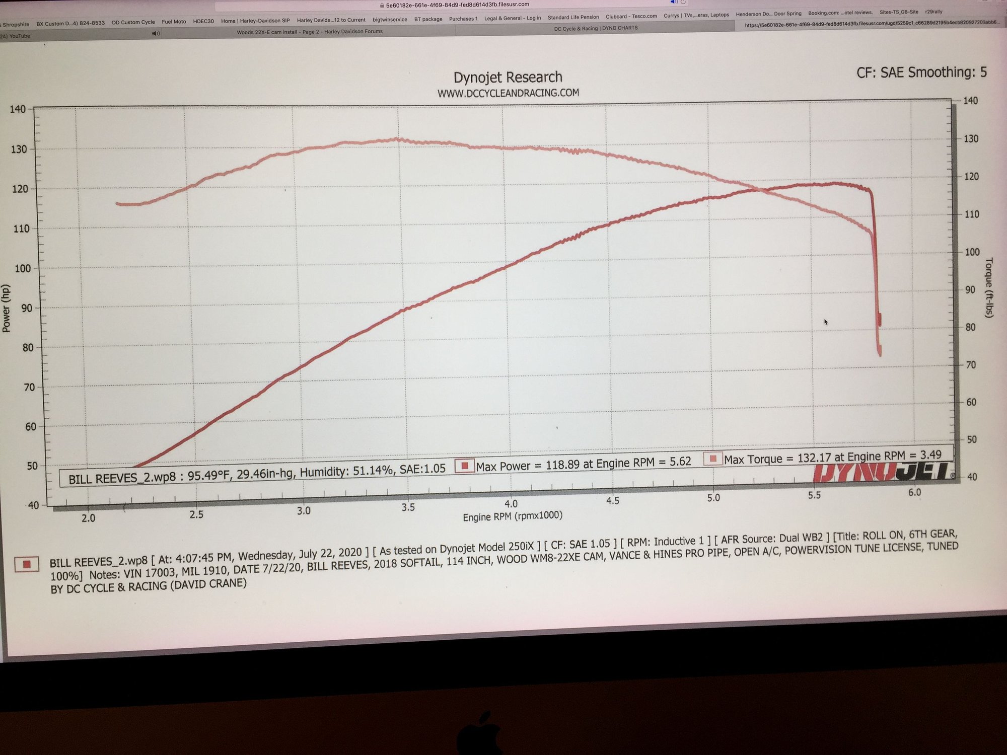

Seen a 22XE with pro-pipe that worked on a softail think DC Cycle & Racing (David Crane) tuned
