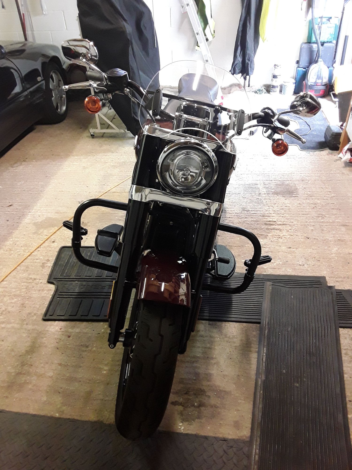

Then get one of these.
A smaller and more angled = plenty of body wind protection and smooth airflow around your helmet. I can ride comfortably at 80mph+ with this screen and no buffeting.
