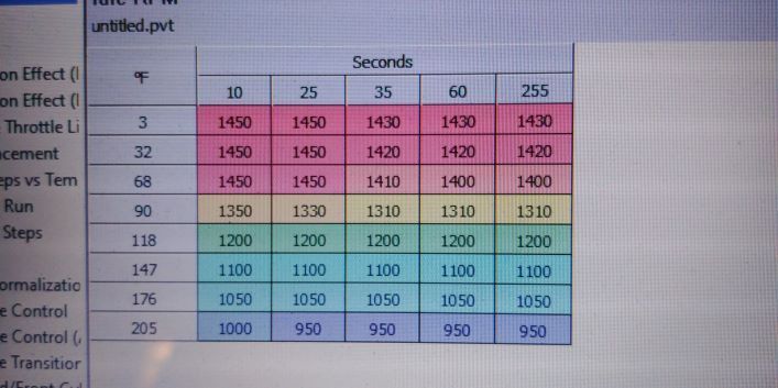

Originally Posted by Tampa Fatboy
Dealer told me it is what it is, my cold start is 2500 RPM for that first 2 seconds, down to 1400, and with time idle is 940. Stage II MAP, dyno tuned.
I have questioned them and everyone I can about this. I hear there is no adjusting the cold start up MAP.
Thinking maybe their Pro auto tune for another 400 but I'd be ticked off if that couldnt get it.
You can ajust the cold start up map here's mine on the PV.
You can set any rpm to anything you want.

Thats what I've been thinking, they slap a map in there but dont adjust any paramters if the dyno is acceptable.
Thank you
Big diff between HD's limited MAP and aftermarket. Thats where you get short changed.

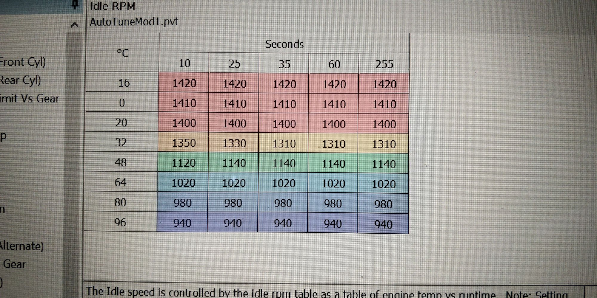

SoCaRider. This is what's in mine. No 1700 RPM. Wonder why it does that? Thanks for your help. SR
​​​​​​Thanks for posting that pic gives me a better idea were I need to be , can you post a pic of your WarmUp Enrichment, been playing around with mine. Are you running a cam ?

Recieved the pic Thanks that's were I was originally my bike was running rich on start up so I keep turning that down
