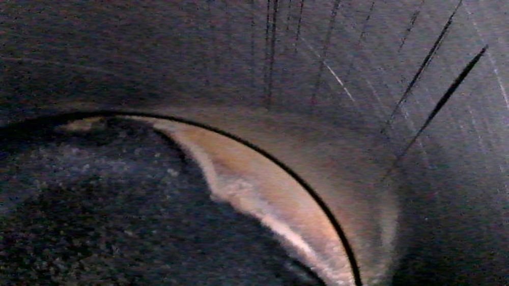

Looks like the head gasket is going to fail real soon .
Ok , I think it’s time to look at the rear cylinder too .

Follow up- showed my local Harley tech today my observations. Verdict- no cause for alarm and to continue riding. Oil most likely from rings and not uncommon to have oil at top piston area. Scoring is minimal and normal. Carbon is slightly heaver than normal.
Harley tech will say anything to make you happy. We need a look at that other cylinder.

The rear cylinder does not show the same other than carbon buildup.

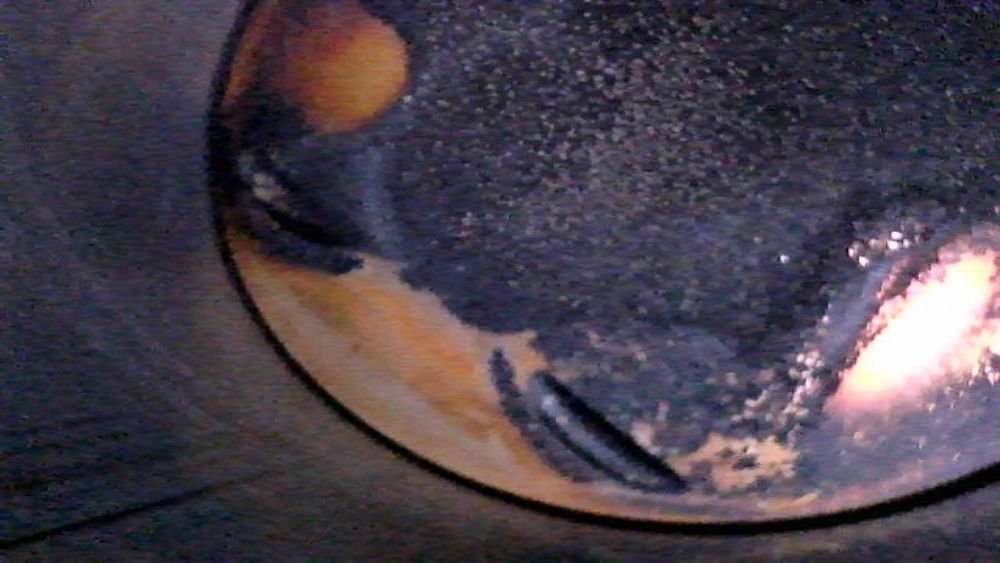

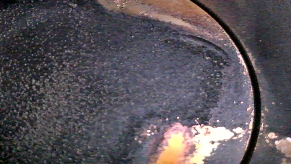

OK, here's the big answer to the question: DO BREATHERS MAKE A DIFFERENCE?
These are the only views I can get with the cheap China scope.
