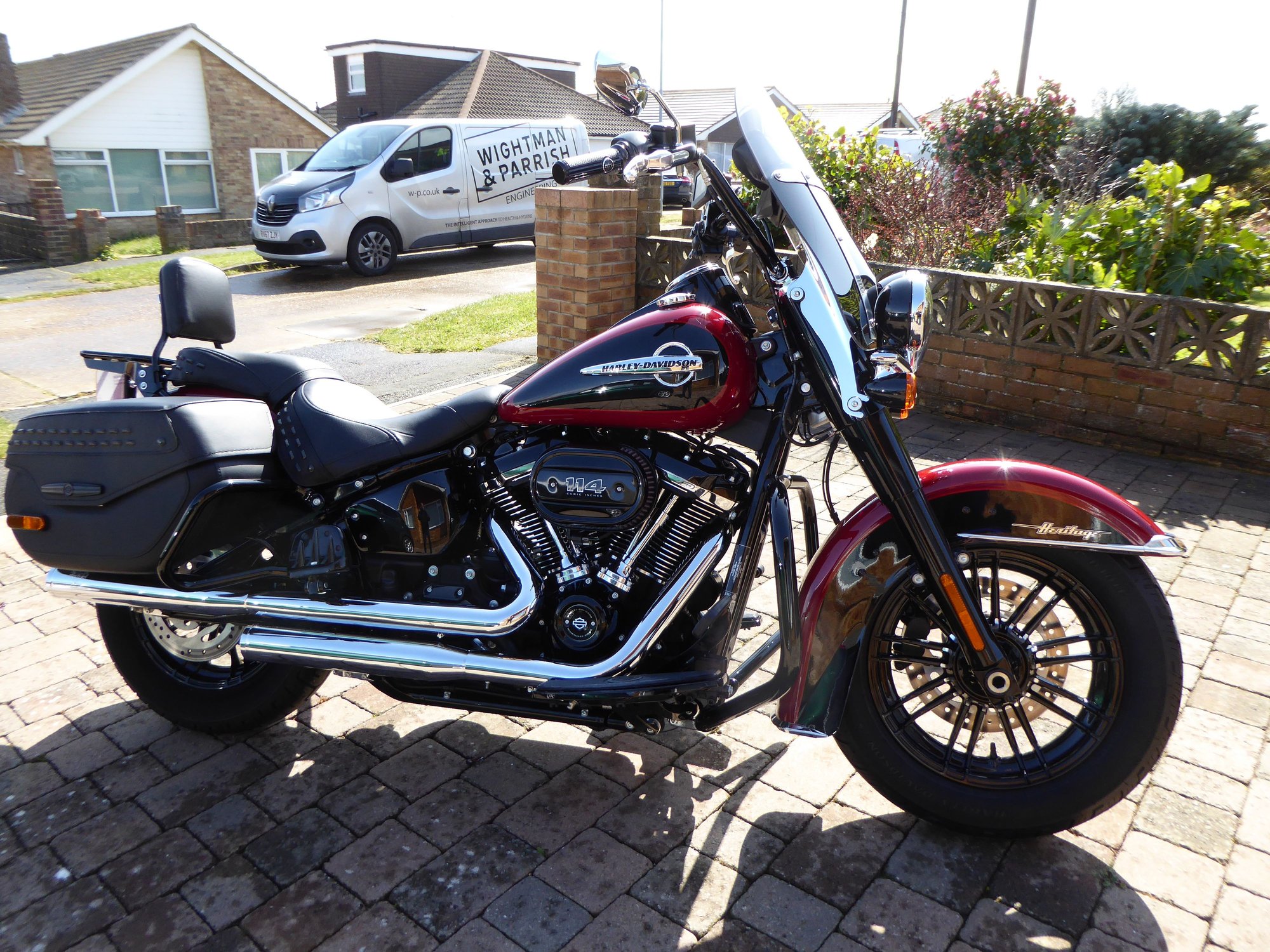

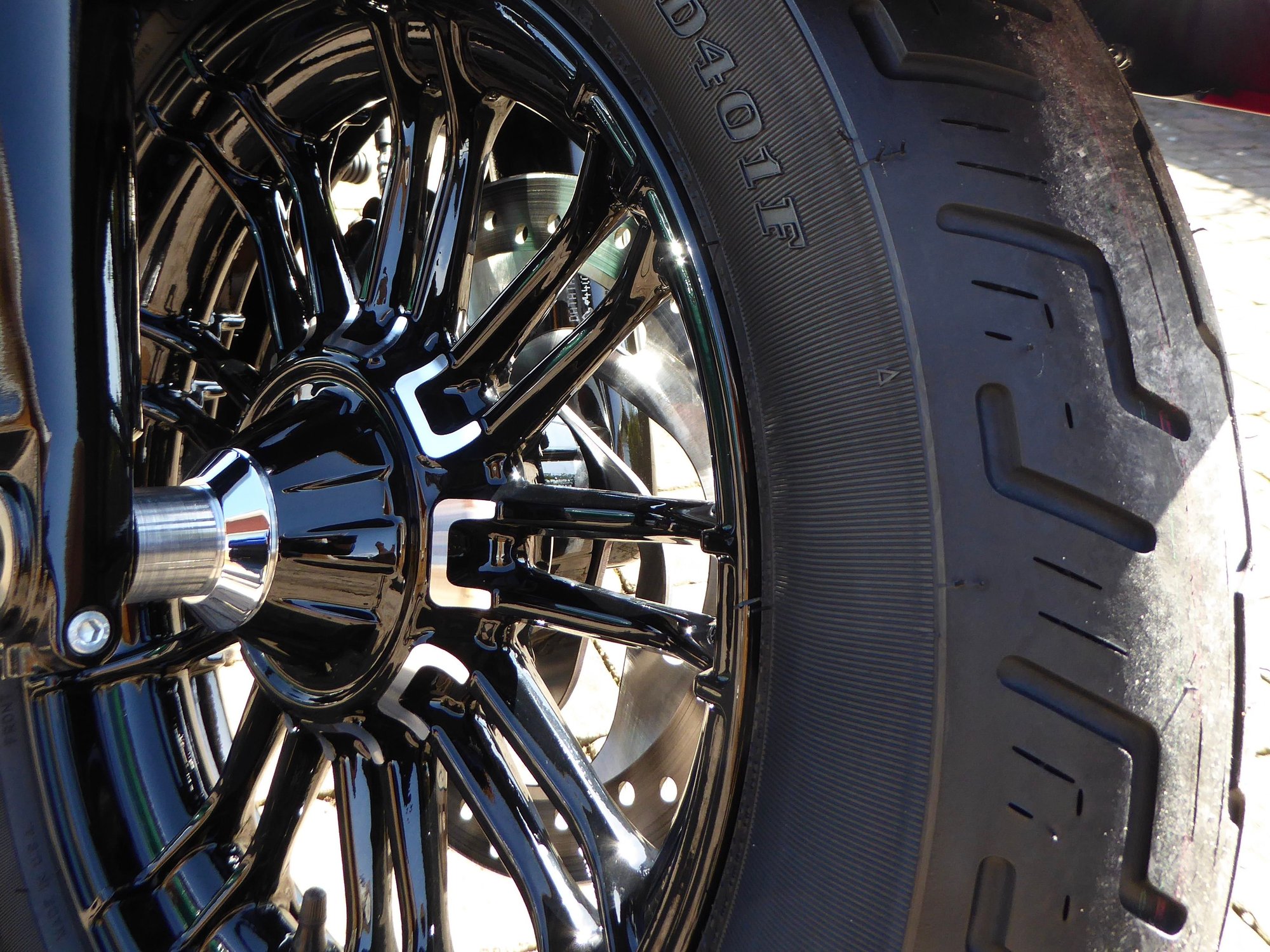

Originally Posted by ukkev
These Sportster 48 wheels (16"x3") were adapted to fit my Heritage by my local dealer, Sykes H-D in Sussex, UK.
That looks good.
Now, those would be ideal! Do you happen to know what they are called (if they have a style name?) and what had to be done to adapt them?
(I like the colour of your bike by the way....nice)
Thanks for posting.
Thanks for posting.
Hi Big Si, thank you... They're standard Sportster 48 wheels, the rear was reversed to facilitate Softail drive/brake disc design as they're on opposite sides on the Sportsters. My dealer, Sykes H-D in Sussex, UK, facilitated the fit, apparently primarily using Harley original spacers from their parts catalogue; a good Harley tech local to you should be able to adapt the same for you. Sykes H-D do have an integral speed & custom shop and employ some great open minded techs... Or of course, give Sykes a bell and ask if they'll replicate the mod for you? Say it's as per Kev Ridout's Heritage, they'll know the details...
Thanks Kev, (great name by the way, very apt for a bike fan!) You're a gentleman and a scholar! Hopefully they will be reasonably priced, but knowing HD I won't hold my breath!!
