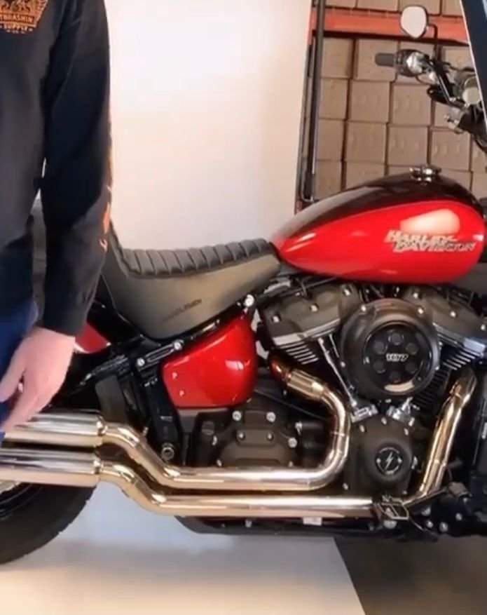

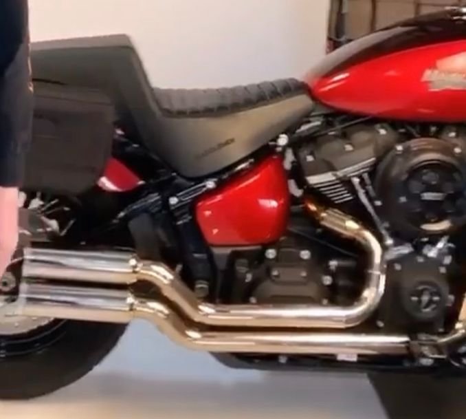

I got an email from Thrashin’ and that 2-2 pipe is coming out at some point so I’ll wait for that.
Also the black V&H Upsweep 2-1 in Spring as a possible alternative.

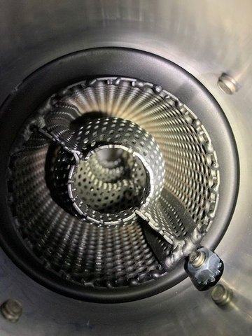

Since you mentioned Thrashing Supply, check out their DogBalls anti reversion baffes. Moonshine has had great success with them.
I've also seen some people experiment with birdcage iron drawer ***** and mounting them in their pipes for reversion control.

It’s that low-end dip I’ve noticed people mention and what I want to try and avoid. I’m super happy with the performance on mine with the stock header and Eliminator mufflers, and the baffles act like torque inserts. It just doesn’t sound great.
That upcoming Thrashin’ 2-2 mentioned above looks promising, it’s a full length pipe and has an additional bend near the swingarm so that’ll help a bit too.

I am also waiting for Thrashin Suply 2-2 exhaust ^.^ I saw another polished version on their Instagram and it looks like super jewelry! I am very interested in it and I want it
