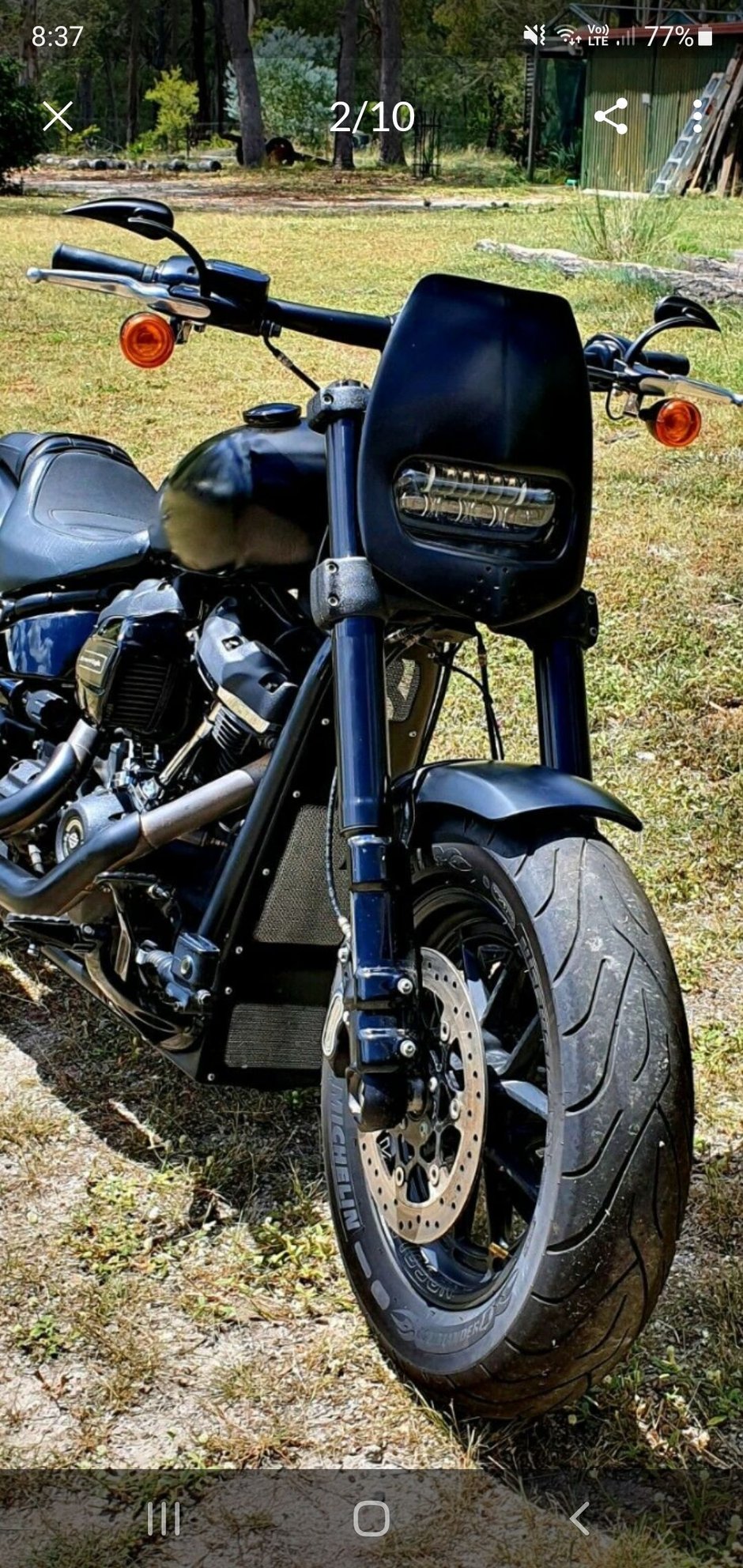

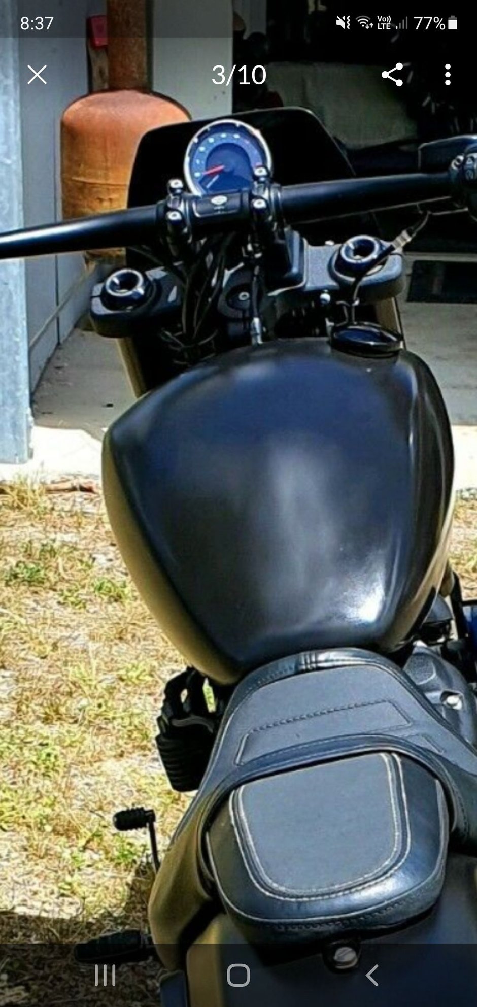

Hi, I've just stumbled on your post. If you are still looking at relocating your gauge. I bought this 2018 FXFB 107 second hand. It was already customised.

Had the same reaction. All the Harley's i've had except for an 06 Springer, i've moved the speedo up on the Handlebars, so it's in my sight line. Also on the tank the speedo on my 2018 FXBS would fog around the bottom where it shows the speed. Still fogs where it's at above the handlebars, but less and towards the middle of the speedo. Also replaced the tank to an FXDR tank. Speedo relocator is from FXR Division, but only ended up keeping the speedo frame and gaskets, had to cut the mount (holes didn't match with the stock risers), and created a thicker mount and welded to the FXR speedo frame. Powdercoated and installed it.
