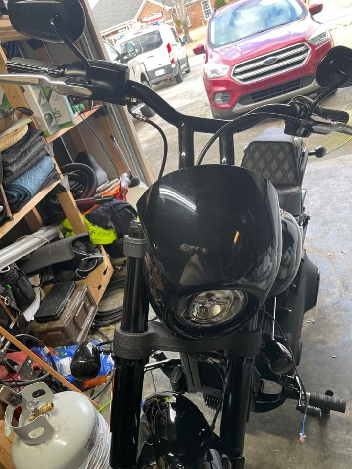

Someone help me out, I can’t find a decent, complete front turn signal relocation kit for a 2020 low rider S. I need to get my signals off the bars and on to the forks so that I can fit my fairing with my new t bars. Any help is greatly appreciated.

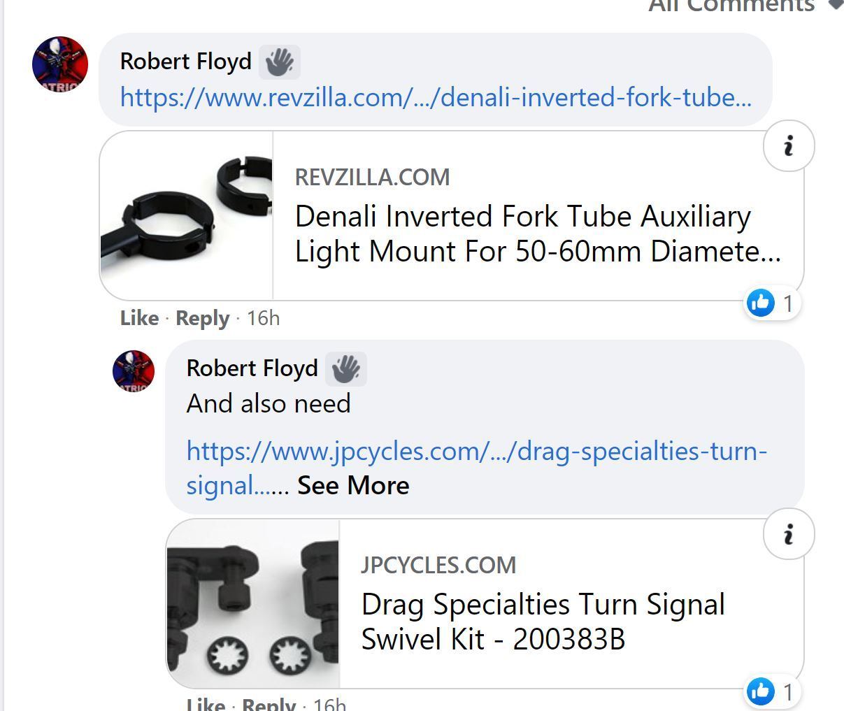

Often there are not ready made kits available for the mods we like to do. I've not seen an easily available 59mm fork clamp meant for turn signal relocation, but I did see on Facebook somebody got busy to come up with a combo that can work.
