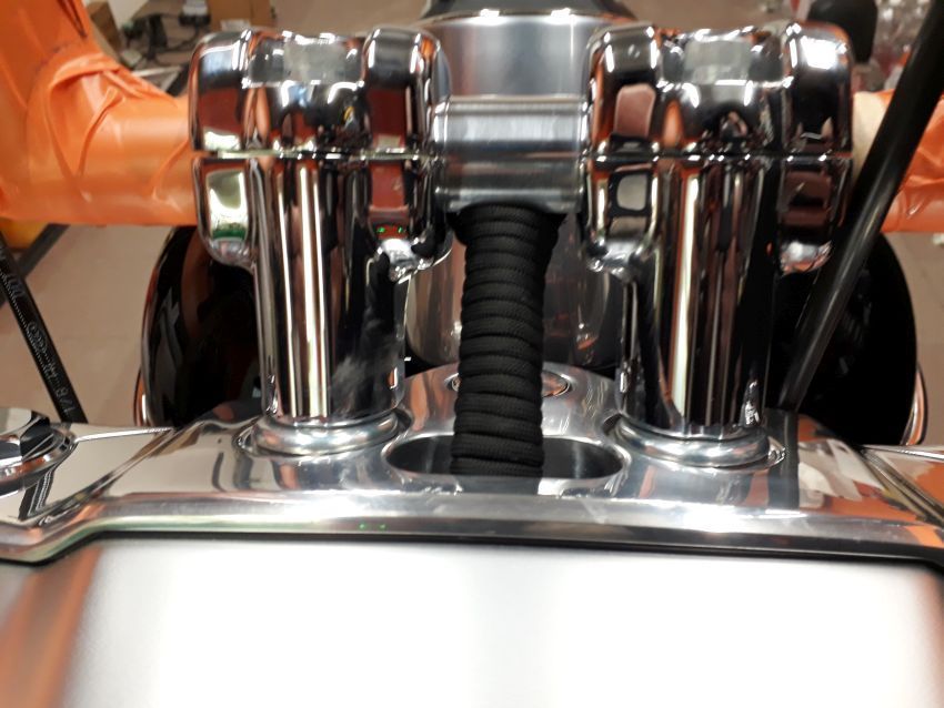

Yes it was easy for me, I have a FXBB in the garage and could easily measure it up. Also I opted for this brakeline and the rerouting of the clutch cable because it then follows more the lines of the handlebar as you can see in the picture.
To clean up the cables that comes out of the handlebar I used a black paracord, now it looks like one big cable.
The only downside now is that I have to do all the work again, the handlebar is loosening some chrome at a certain place and the seller has already provided me with a new handlebar so that I can replace it and then give this "damaged"
back to him. Good service, but was not waiting to reinstall the handlebar, I was glad it was on because of the shape it was not easy to get the wires true it.
