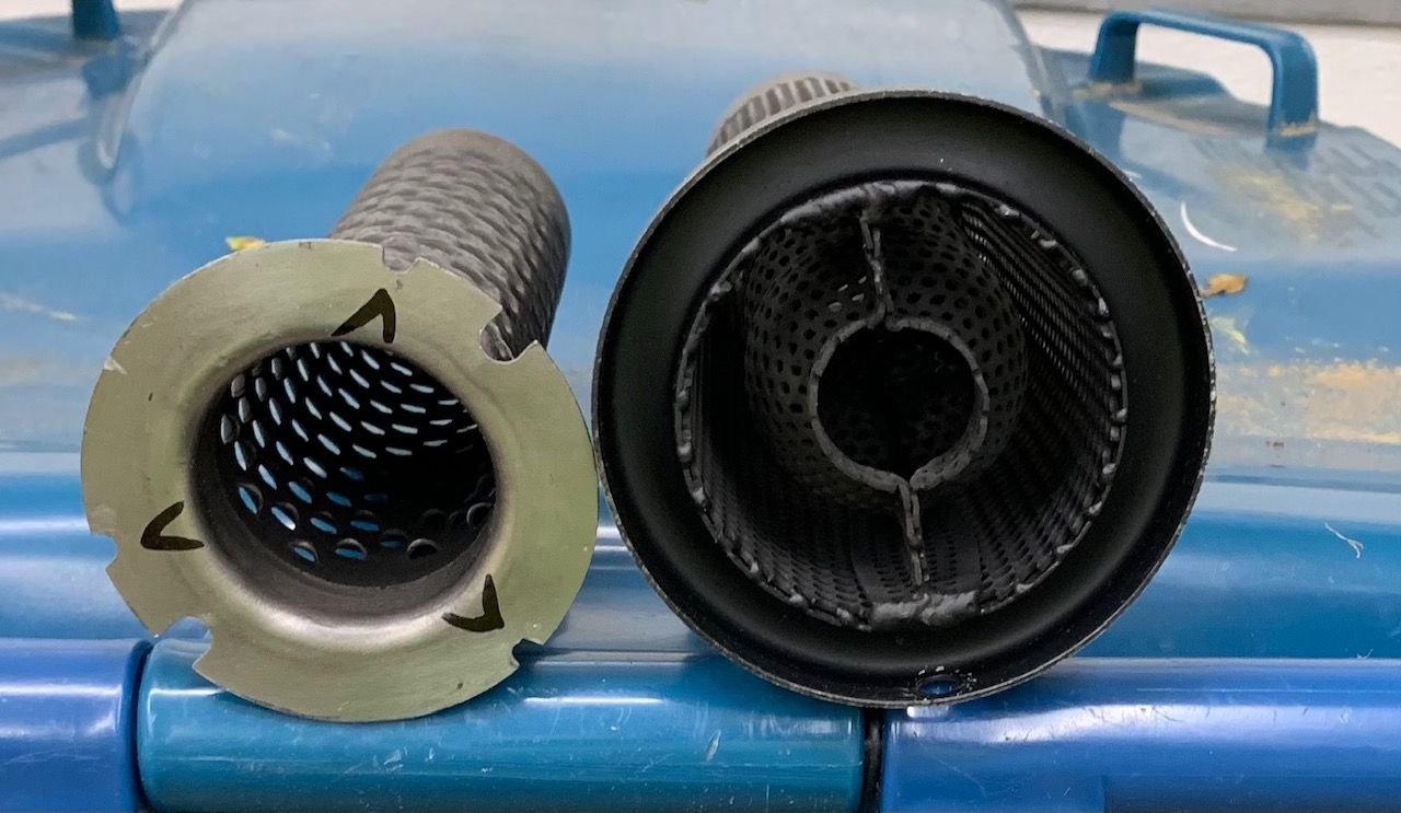

It is not a shorty.
I run a smaller baffle than the 1955-0 in my 131" and make 157hp/165tq, you can draw your own conclusions.
The design with anti-reversion chamber makes it expensive, Moonshine Harley uses their own exhaust with this design and they know how to make power.
I ran a Bassani Road Rage III 50th Anniversary exhaust that has a similar design minus the anti-reversion baffle and smaller head pipe and baffle etc. I think the assembly of this Thrashin exhaust is done by Bassani, I liked the Bassani RR3 50th but needed larger for my 131" with 11.5:1 compression. I think the Thrashin explanation of their baffles is aimed more for race bikes than street, I tried two larger baffles, they are big and LOUD.
Here's a pic, I think the 1955 baffle next to a 1-7/8 S&S baffle.
