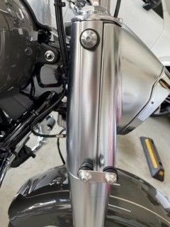

Never used a Memphis Shades brand on my Road King, opting for a LRS “Recurve”. I’m 6’-1”. My pillion never complained about buffeting either. There are other areas that wing comes from that you may want to address as well, such as from the front of your tank.

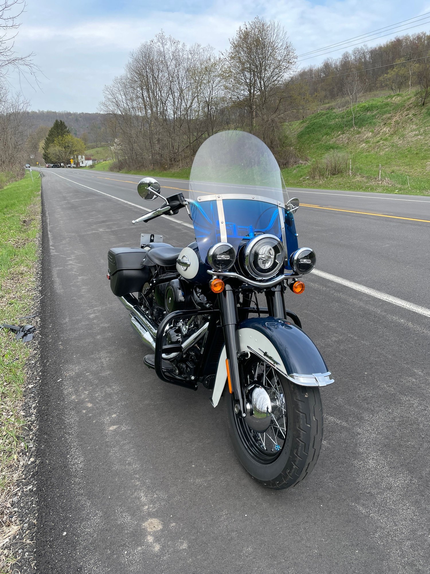

I needed a taller windshield for my '19 Heritage and wanted the color tint like Memphis shades offered. Unfortunately, they don't offer a replacement windshield "glass" to fit the '18 up Heritage as the screw spacing of the horizontal brace is different from previous years. I solved the issue by replacing the horizontal braces with the braces from a '01-'17 Heritage Softail windshield. That worked perfectly-see below.
Yes, I realize it's not a "whole windshield" and requires reusing your hardware (most of it), but it IS a solution and it works.

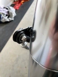

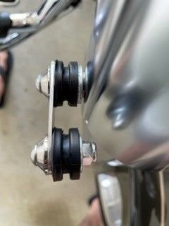

This is what I did to great effect. Essentially just laying the windshield back giving a much cleaner air flow as I use to get that barn door buffeting affect. I now get air that pushes just on the top of my helmet. Im 6'2"and use the HD 19"screen. I had some washes machined up to match the OEM ones and used the rubber grommet from HD
