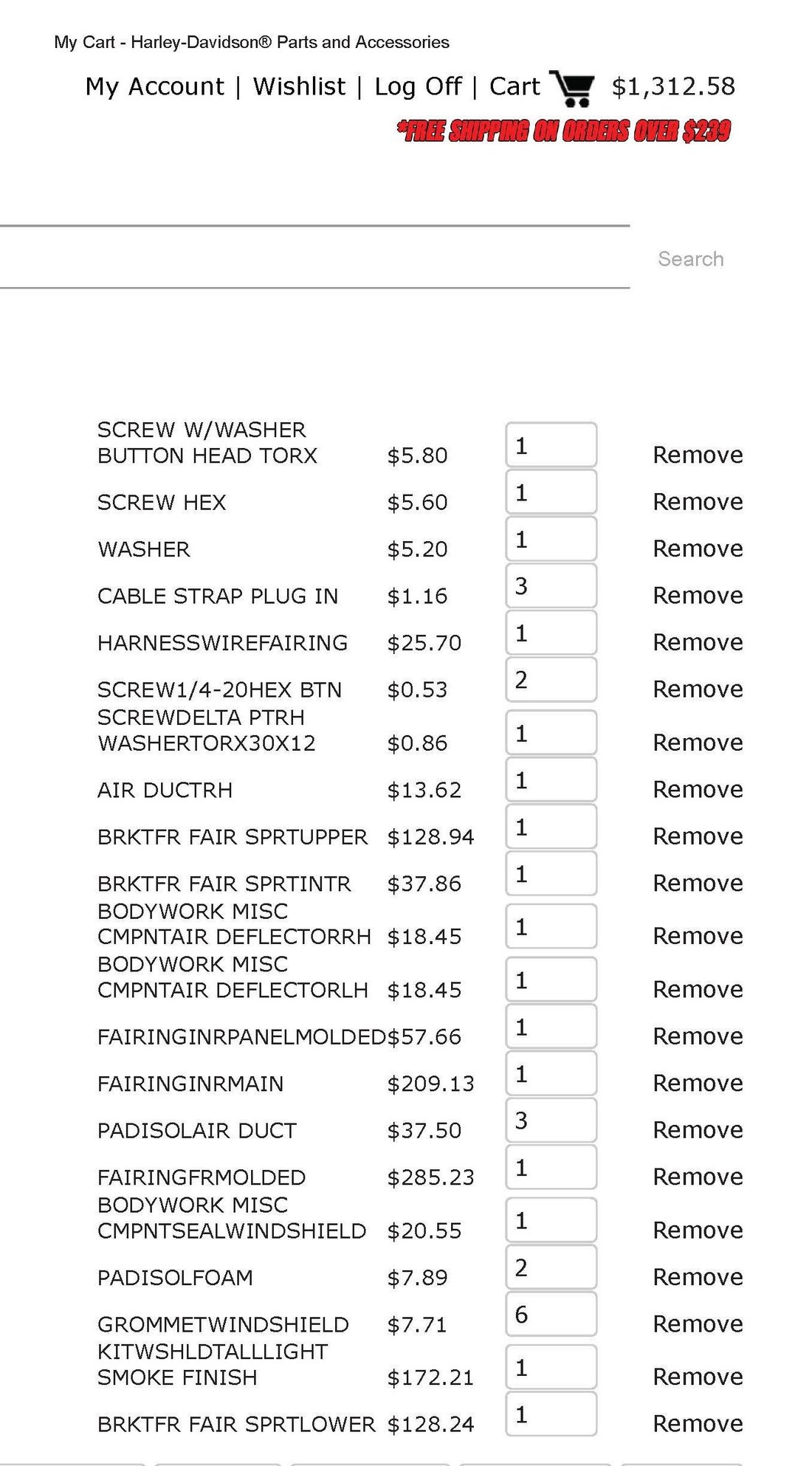

Here's a list from Surdyke. The whole mess is like $1312 and that is with the 10" windshield, which I will probably delete. This doesn't include the headlight, I'm looking aftermarket, around $600. I figure paint should come in about $500. There is about $50 worth of misc. parts weren't listed on Surdyke. So, $2500, unless I have missed something.

^ I know what you got. was just reference. I guess alot more moving parts too.
just seems overly...reasonable. go for it. might be the first one to do it.

Yeah, I kind of had the same feeling about the overly reasonable. I want to see if Surdyke can do a check to see if anything (or everything) is in a backordered state before I push the button. I'll take you up on the windshield if I get to that point, which I will if no parts are on backorder forever. I'll let you know something this week. I realize it will be a little while before you can let go of it, at least until KW has their windshields available.
