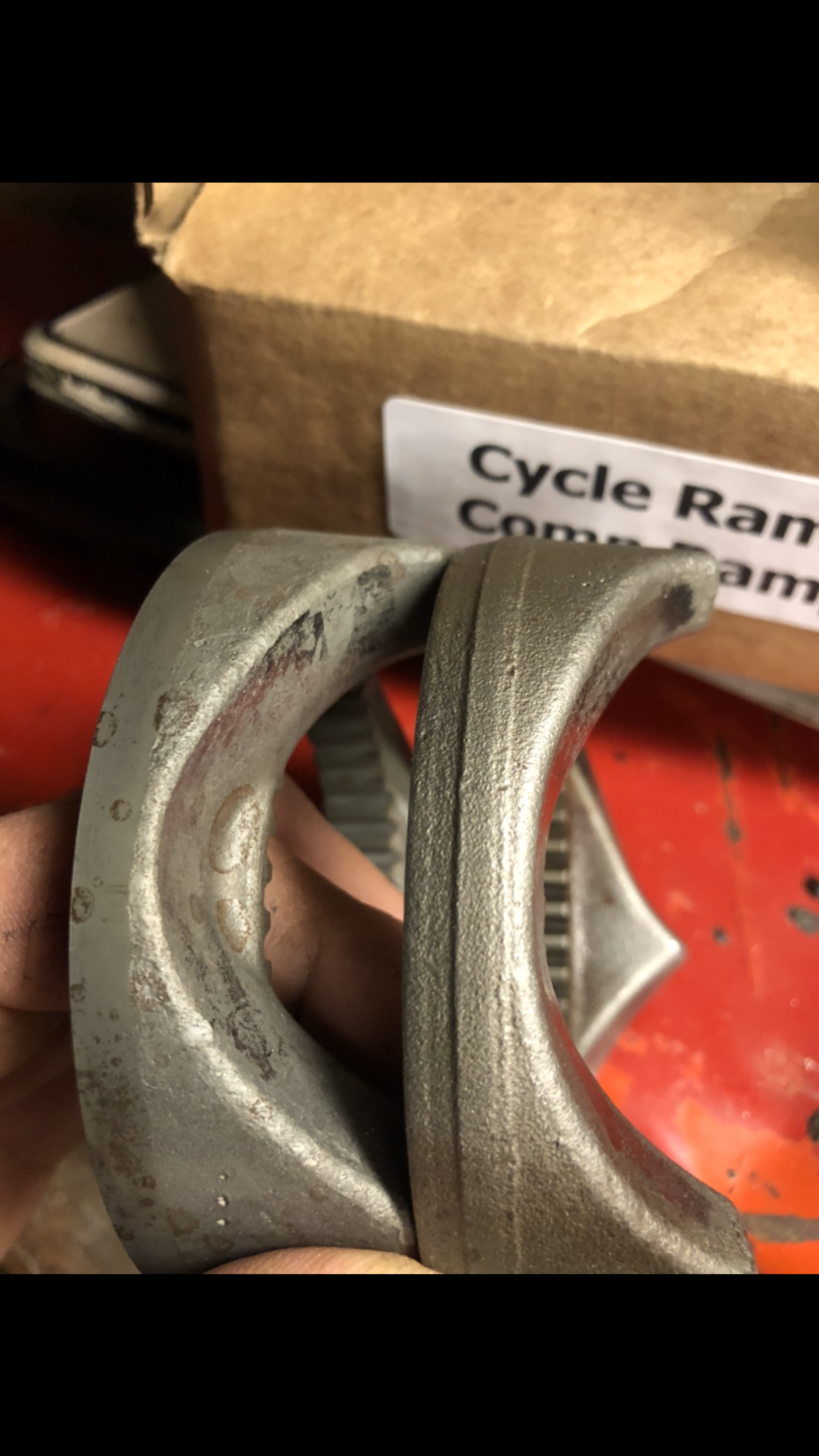

Ramp on the left is out of my m8. The other is out of my twin cam. M8 comp ramp is $hit!
