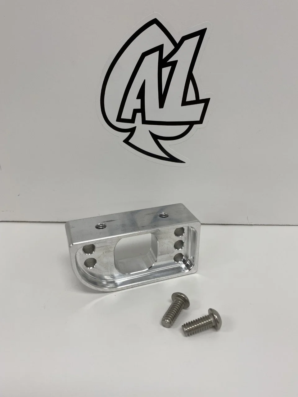

I am interested in the FixStand or possibly the Imzz. But I have the 1.75" Bunk King extension so it already has too much gangsta lean. Plus when I find one I plan to swap the 43mm for a 56mm rear shock. This part pictured above has 1.5" kickstand lift. Curious if anyone has used it? Thoughts on it?
