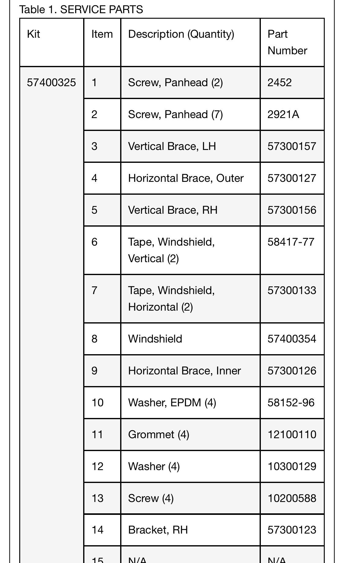

This might be a bit of a stupid question but I often see people selling used windshields for much less than the 400+ Detachable windshield and hardware combo Harley offers, but often times they won’t have the hardware.
Looking at the parts store on Harley I can’t see any option to simply buy the hardware which just seem like 4 bushings and longer screws, somewhat similar to the docking hardware for the detachable sissy bar.
I have a Softail Slim S, the only windshield hardware I can find on Harley is for older road kings, they look very similar but it doesn’t list fitment for my model.
Anyone run into a similar issue or can point me in the direction of where to buy this hardware?

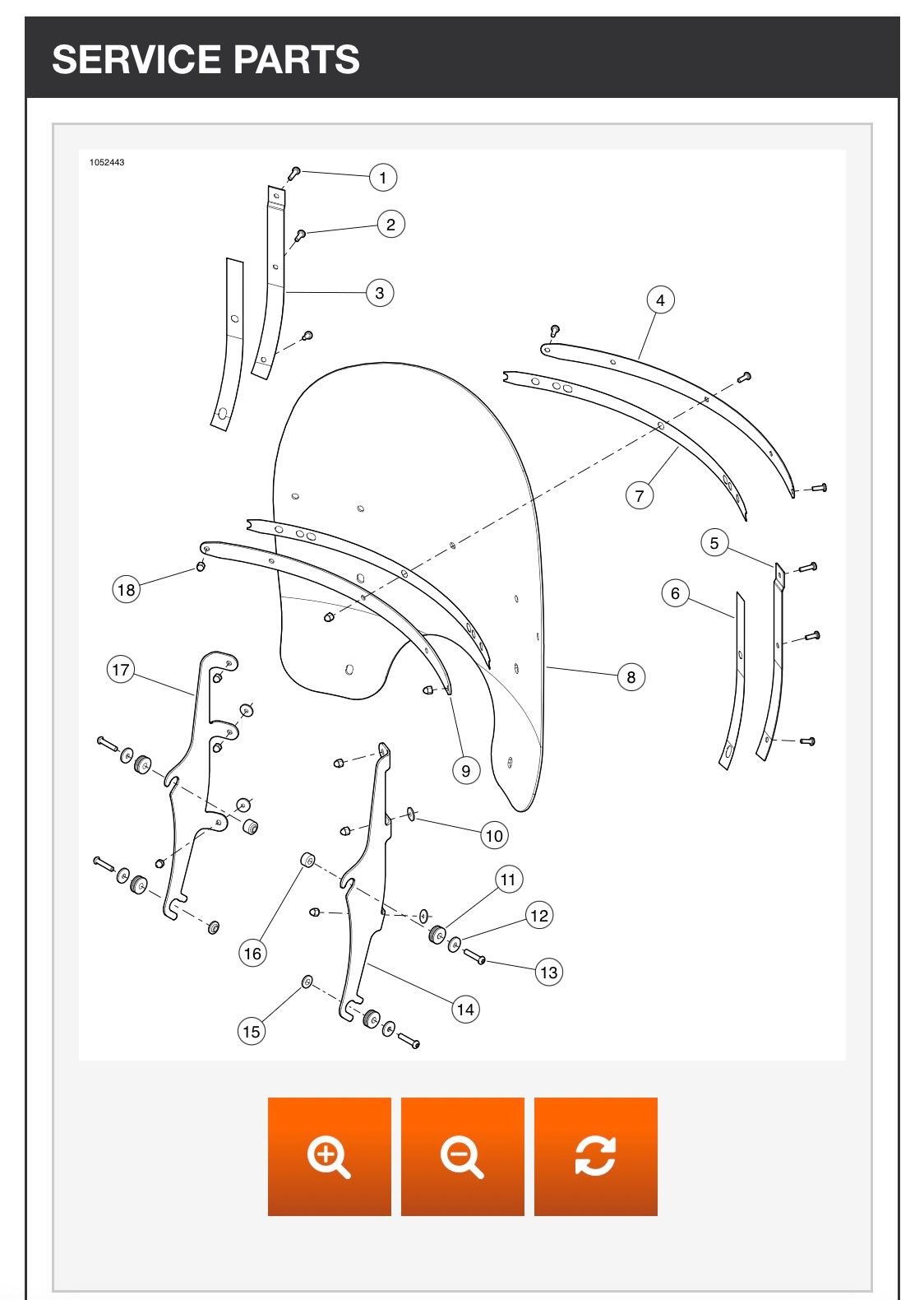

I don’t know which HD windshield you’re considering, but if you look at the Installation Instructions on the HD website, there is usually a list of Service Parts. For example:

thank you so much. This helps
