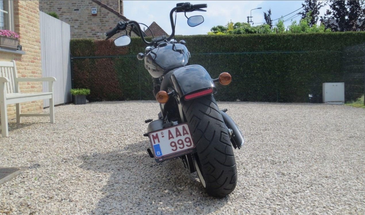

I have ŕ 170/70 Shinko on 4,5" rim , if you measure this after mounting with a caliper, that gives exactly 175 width.

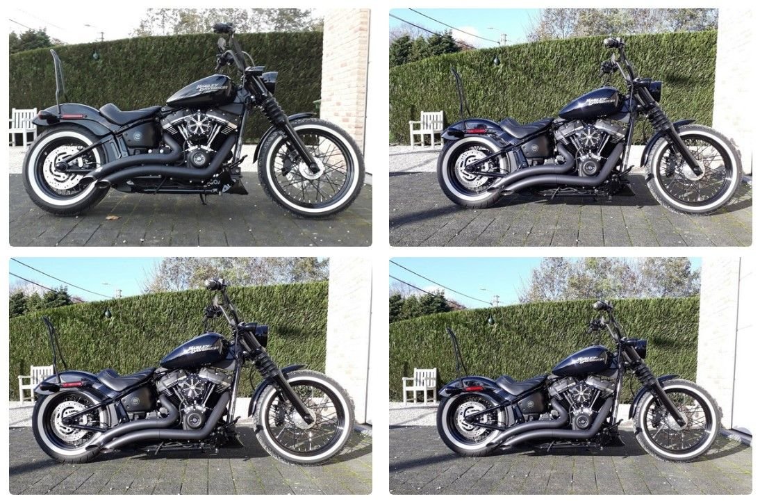

This setup can be done without any other modification. I even have air suspension and can ride on the lowest setting without the tire touching the inside of the fender.

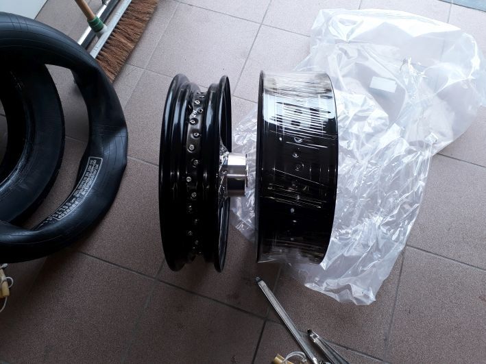

Compare between stock rim 16x3" and 16x4,5"
170 Shinko installed
Different positions, even the lowest position can be driven
