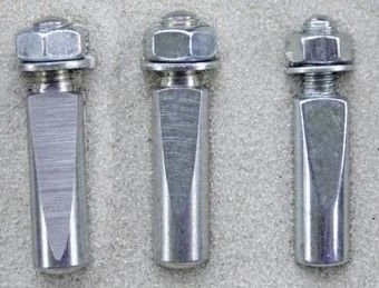

A side note, as an engineering apprentice I was taught that the below is a cotter pin which is used as a wedge type securing for things such a British motorcycle kick start levers and bicycle pedals and the other is a split (cotter) pin to avoid confusion!
