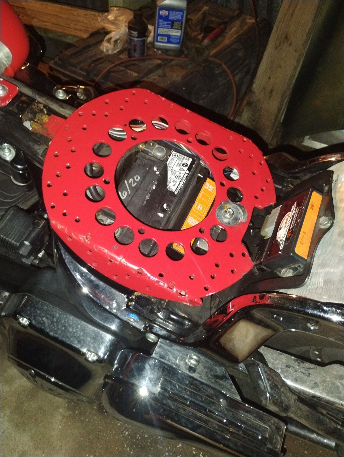

I got tired of the same ol seat configuration. So instead started my own patent of design to fit my personality. It's a combination of control. Kinda like a mid engine vehicle. If you understand those concepts you'll understand my design.

Old Aug 19, 2024 | 12:53 AM

Originally Posted by Shaggy520
Wow this pic came out pink wtf 🤣
Fabrication from motorcycle brake rotors
