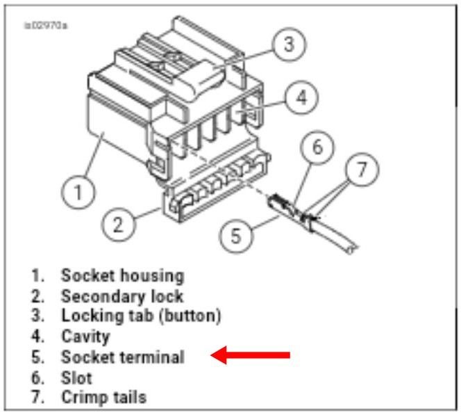

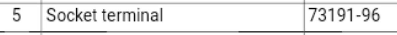

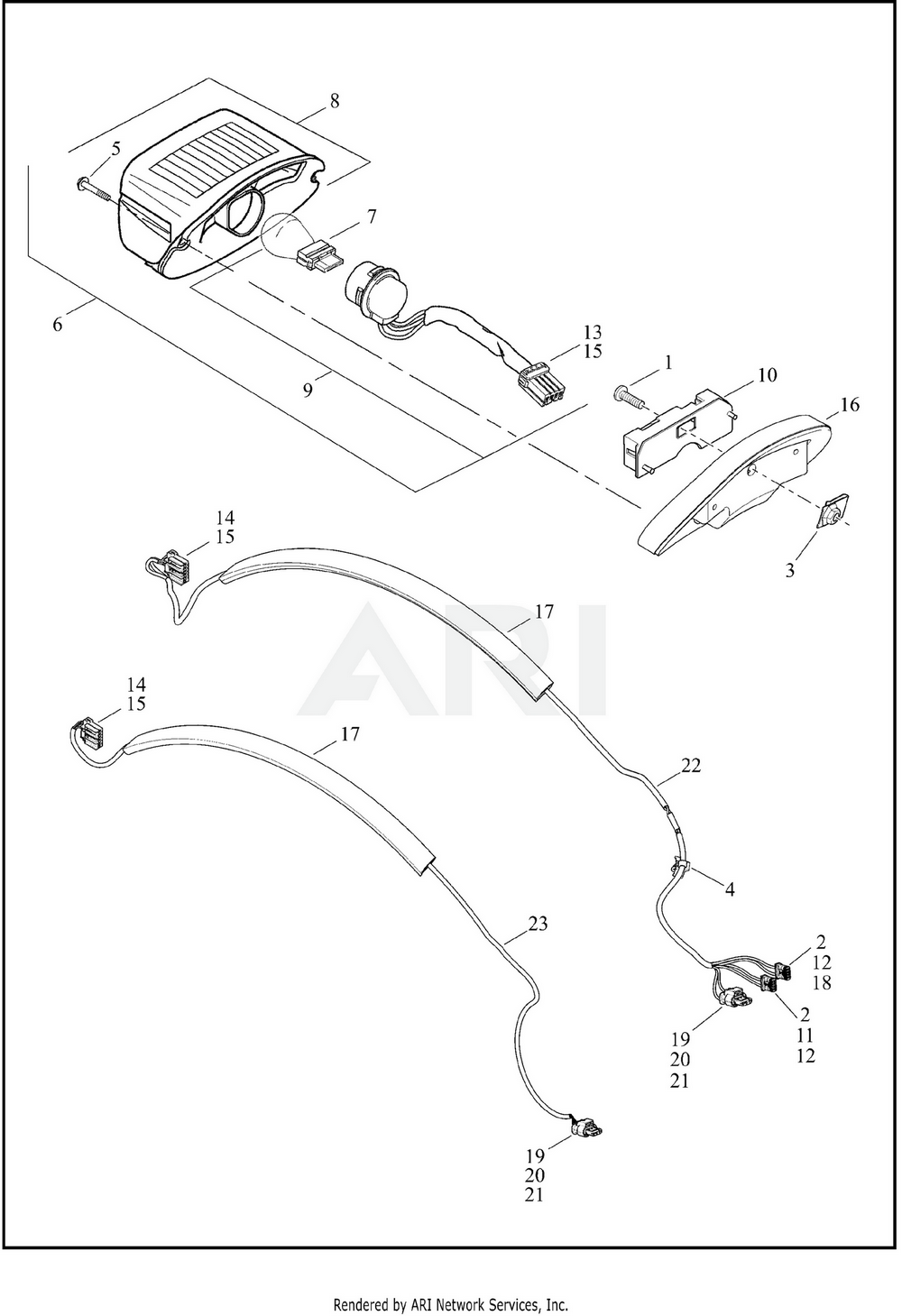

Originally Posted by CoolBreeze3646
Does not show separate pins. See Below for PN of the Socket Ends.
Hope this helps.
Ref:13
73154-96BK
HOUSING,4-WAY,SCKT
Price: $1.79
Ref:14
73156-96BK
HOUSING,6-WAY,SCKT,SNGL ROW
Price: $2.09
Ref:15
73191-96
TERMINAL,SCKT,#16-20AWG
Price: $0.58
Visual of 73191-96.
