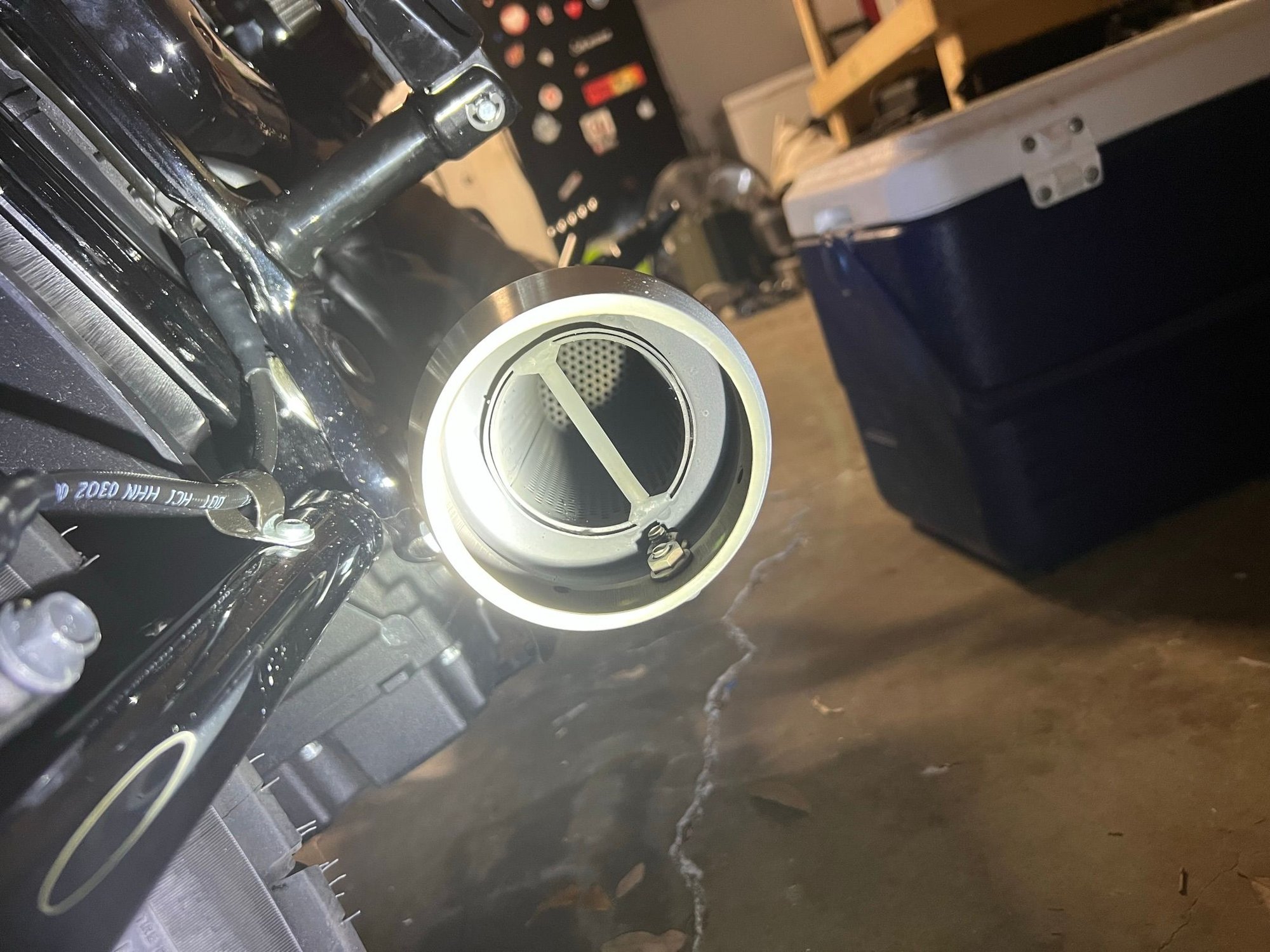

It looks like there is some sort of baffle in there, I don't see any fiberglass material though. Thing is loud AF, louder than I wanted actually, didn't seem that bad in the videos heh heh.

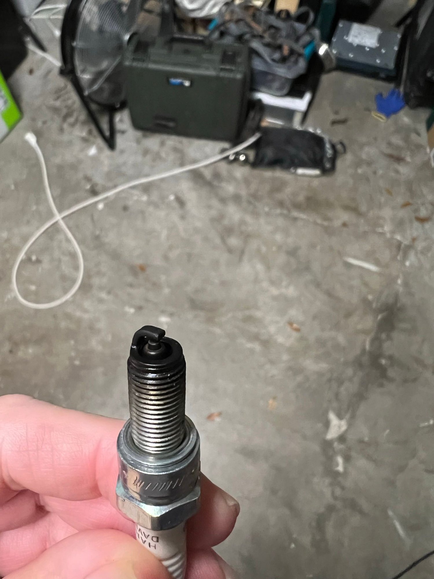

that said, have you looked at the plug wires or plugs
pull the plug and look at it, it can tell you everything , and possibly a wire isnt on correctly

I took a picture of a plug, ~950 miles on bike, last 20 of those miles with stage 2. They look wet even though the bike hasn't been started in about 36hrs. Maybe why my eyes were burning at stop lights?
