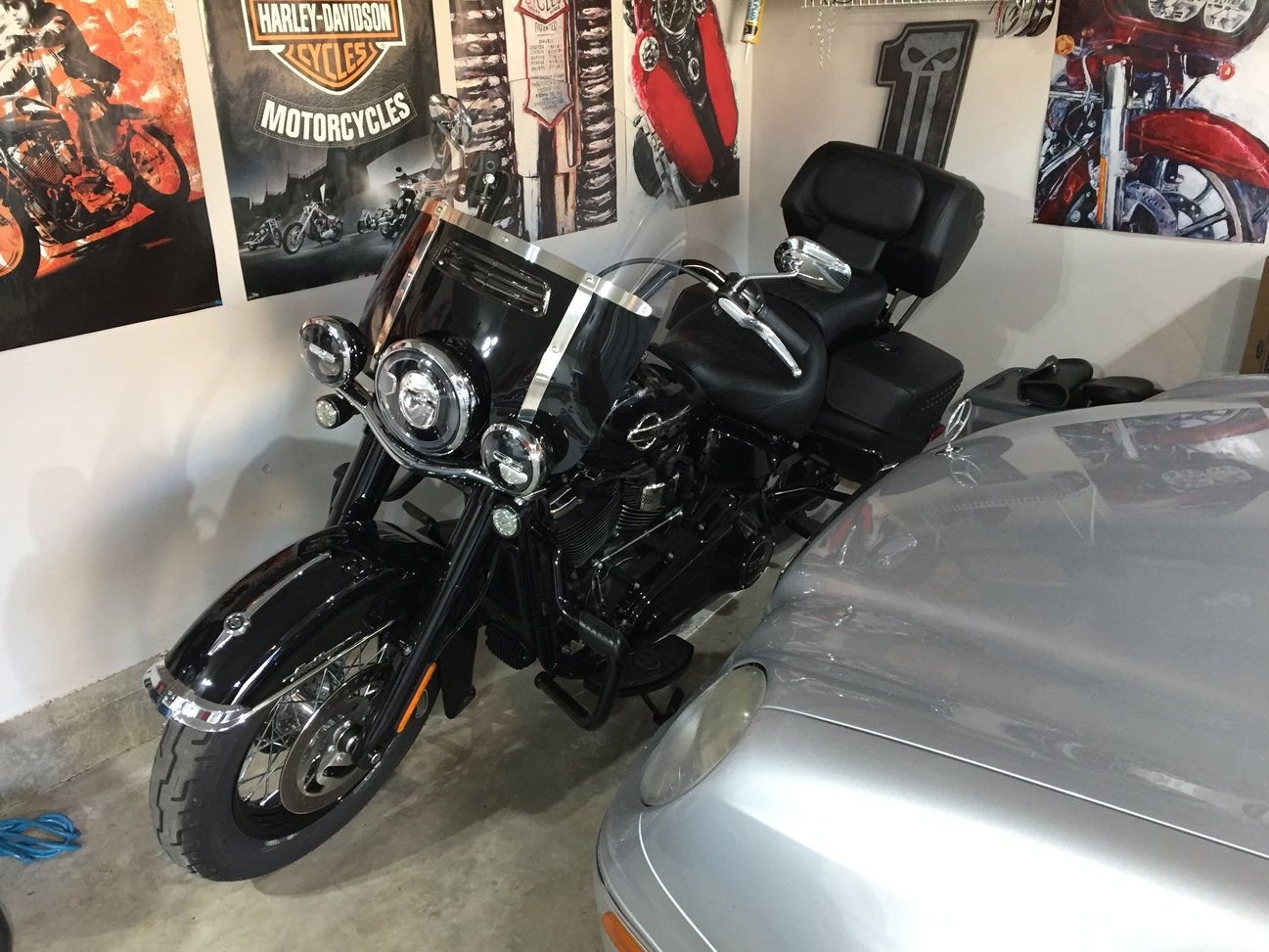

If one is looking for a windshield only solution... I might consider the vent. You might notice that the baggers come with them built into the batwing/shark nose. There's a reason for that, and it's not to keep one cool. The concept is that it helps relieve the pressure differential behind the windscreen that causes the airflow over the top of the windshield to become turbulent. ClearView Shield offers shields with them...
https://www.clearviewshields.com/mot...size-brackets/
This guy opted to have the vent installed below the horizontal frame in the black section, which I think works well from an aesthetic point of view. However, if you want to use a windshield bag, you'll have to have it installed above the horizontal frame (which is what I did). ClearView says it doesn't impact the vents performance either way. All I can say is that it works where I have it. The vent has multiple positions. You have to play with it to figure out what works for you. For me, it's the second position from fully closed. I should also note that I also got the recurve.
One thing to note about ClearView... They used an older design shape for their taller shields back when I bought mine. The best way I can describe it is that the older design is in the shape of a woman's fingernail. If you want the more tombstone shape of the OEM shield, you might still have to request it. Be sure to discuss this with them before ordering. Like other offerings, you can get CV with various other options, recurve, width, height, colors, etc.
