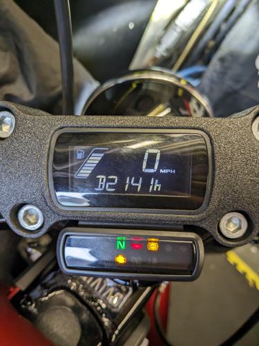

I cannot get the hyperflash on a 2019 FXBB dash to clear

seeing the following two codes: B2141h, B2146h
have cleared and as soon as you touch the signals or the hazard they return

B2141 and B2146 are both Left front turn signal output open and Right front turn signal open respectively. So it would seem you have a prob with the front signal wiring somehow. I'd further say you're getting hyper flashing because the bike is telling you that there is a problem with the indicators.
Until you address this, you are probably pissing into the wind trying to deal with the hyper flash.
Rather than chasing your own tail, I'd strip the front sigs out completely and redo them. Test them laying loose just connected to the harness.
And then check, were the indicators wired through the bars? Did you splice the new indicators into the original signal wires? Check for continuity, Any other rerouting of the wiring? Connections good where they join the main loom?
​​​​​As a small crumb of comfort, when I put Heinz on the Standard, the idiot light hyper flashed, but turning on the 4 ways for 30 secs did the job. So there's that
