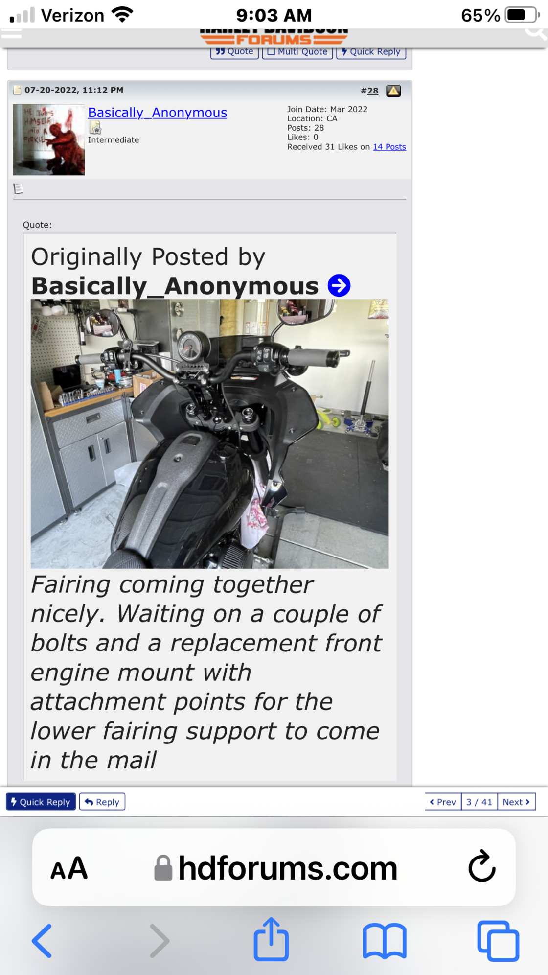

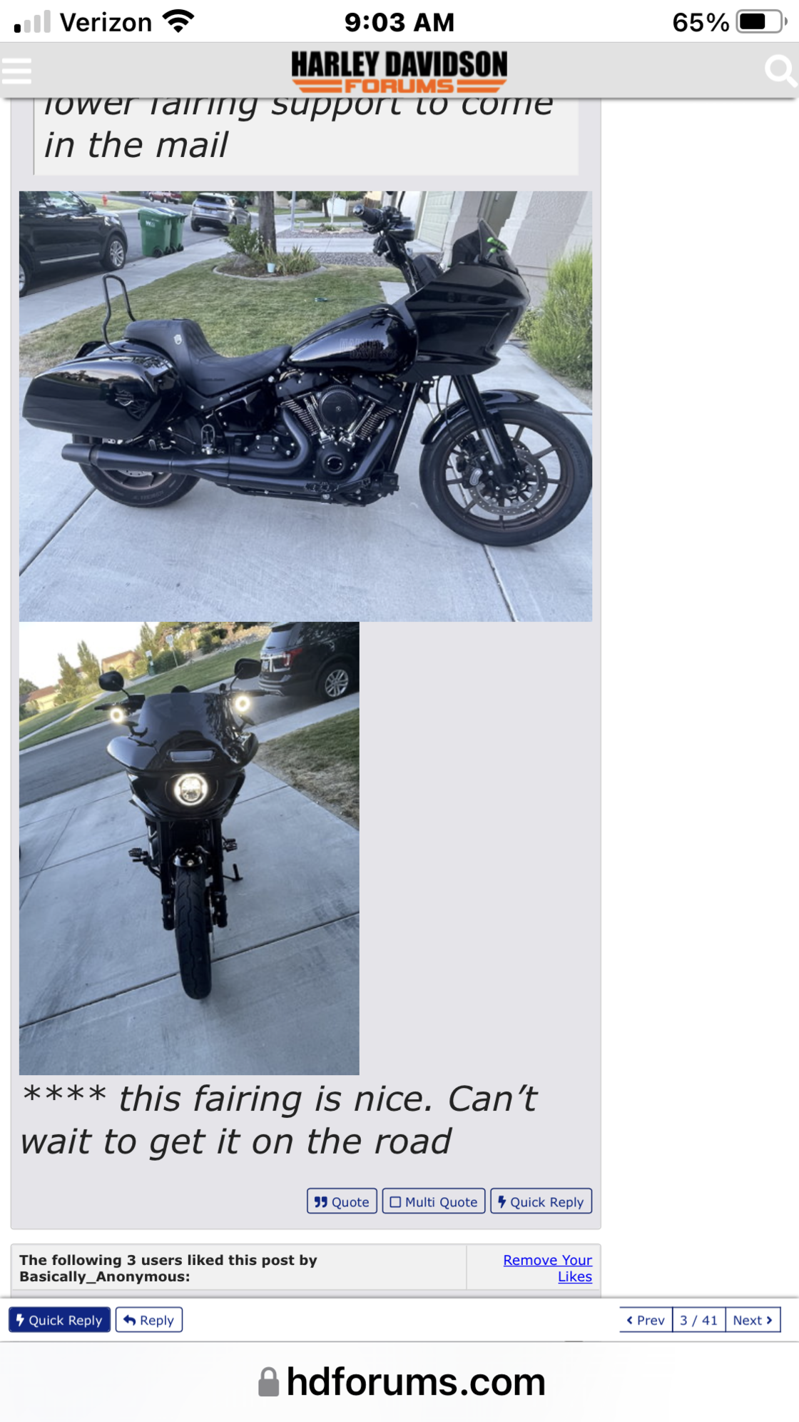

I think there are a couple of aftermarket companies making them, . T.o.l i think. I have also seen on Facebook a carbon fiber one that is coming soon. There was a forum member that put one on his 22 s like a year ago. I can’t remember his name. He did the Harley one. Yours will be an easier install than block heads as your frame is already set up meaning no drilling.

This guy did it.
