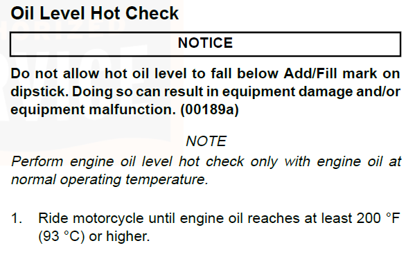

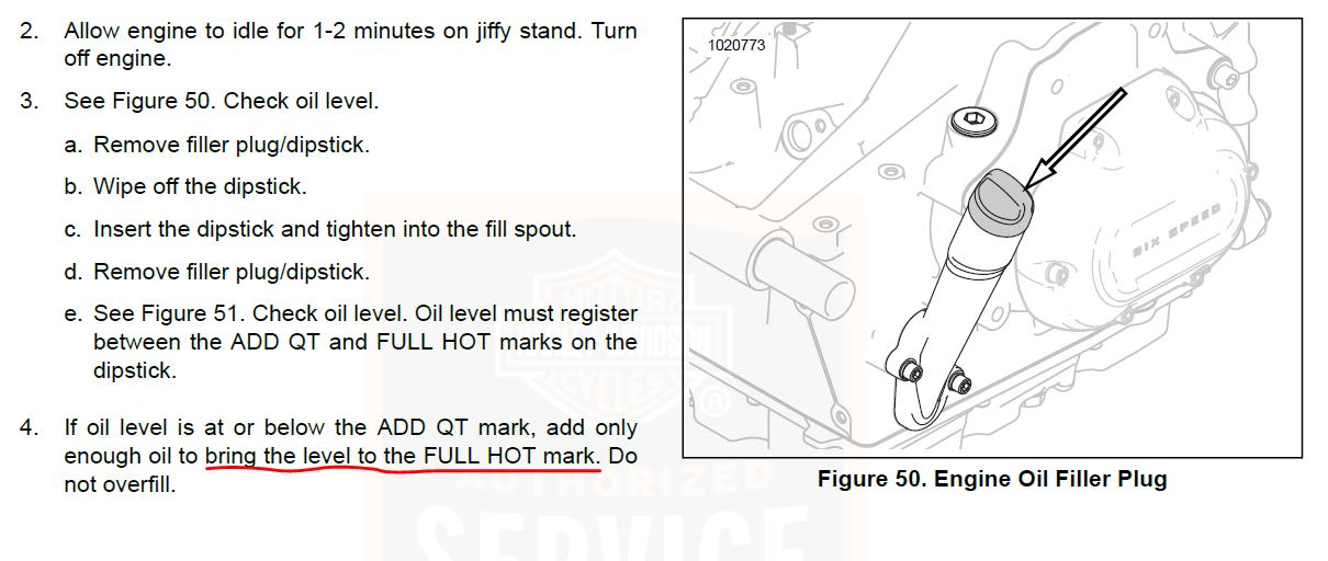

It should never reach "full" hot or cold. Your owners manual calls out it should be mid-way between.
That isn't what my Breakout owner's manual says.
There is a cold check procedure, but hot checks are the only reliable way to do it.

Pretty simple, right? Hot engine to full mark, cold engine halfway.

I remembered to check engine oil level hot tonight. Let sump oil drain 5 minutes post shutdown, then checked engine oil level. Expanded only a couple hash marks on dipstick, pic attached. I filled halfway on dipstick when cold. BUT - it was only 75F degrees out, cloudy so no reflected road heat, no wind. Rode 20 miles, mix city and rural, start stop and highway max 60 mph.
On air cooled engines I'd expect more oil expansion when it's 100F degrees out @ 90mph riding. So I don't plan to change anything. Yes it gets near 100F degrees here every summer in the American Siberia.
