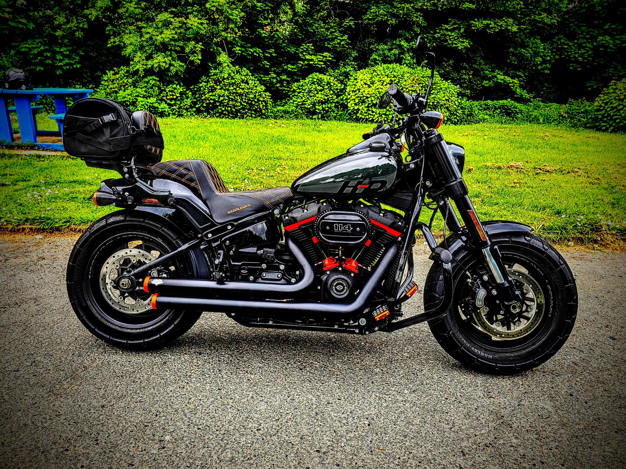

Hi people.Is it possible to fir Harley branded floor boards to a softail that cones with pegs?In my case it's my fxfbs fat bob.The HD website says no

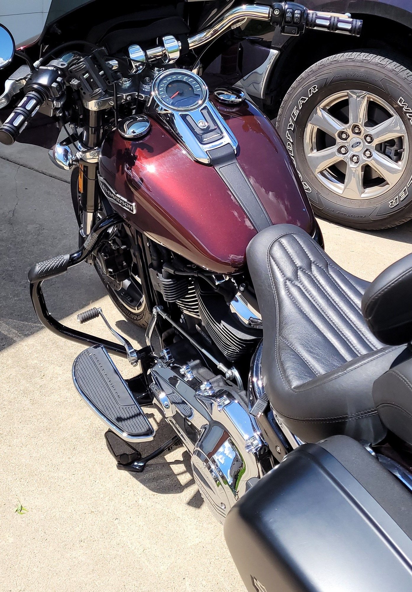

I don't know what year model you have, but in 2021 the Fat Bob and the Sport Glide both use the same forward foot peg / control mounts. I put floorboards on my '21 Sport Glide, so the mounts on your frame are the same as mine. This means floorboard mounts should fit. The Fat Boy mounts are about 3/4" wider on each side than the Heritage mounts. I went with the Fat Boy mounts. I didn't have to change the brake pedal, but yours is different, so you may have to change it. The brake mounts are the same, so you would only have to change the pedal. The shifter mount comes as part of the left floorboard mount, your shift and linkage should work. So yes, you can do it and Harley offers some different floorboards other than the stock ones that you might like. I'm not sure about the aftermarket.

I have a 2022 Fxfbs.I like the Adversary with the orange.It would go well with my bike.

I replaced the pegs on my 2018 Sport Glide with boards from a Fat Boy.
