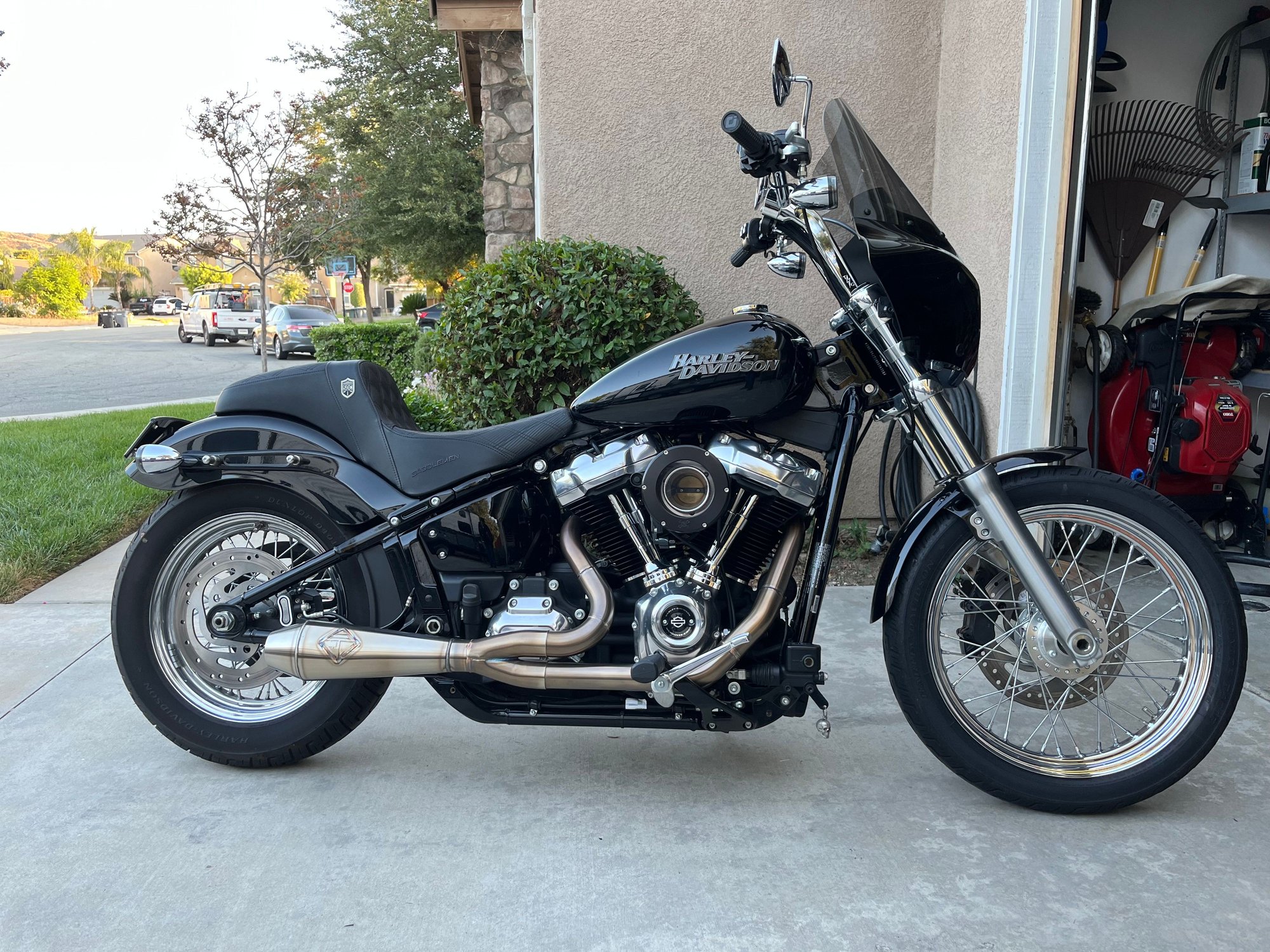

I’m running the 468 cam in my 2021 standard 107. Right now the bike has 105.22hp and 117.20tq at the wheel after dyno tuning it. I like the available torque when around town/highway riding to work. So far I’ve had it up to 130mph comfortably without any wobbles with risers, moto bars and poly bushings installed.(at those speeds ape hangers or stock bushings are not recommended).
parts List.
S&S intake manifold
S&S adjustable rods
S&S lifters
Feuling BA air cleaner
Feuling external breathers
Zippers 468 cam
Dynojet PV4
SP Concepts Big Bore exhaust
Taylor 409 plug wires
NGK 3521 plugs
Lucas Synthetic
K&N 171B oil filter
FM tunes are ok, but if you really want to squeeze out all the power you can while getting the best fuel economy getting it tuned by someone is the only way to go.
hope this helps.
