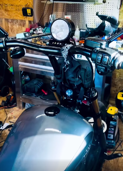

Below is the look I'm going for..
In my case, I'm using Original Garage Risers, ODI bars, and Original Garage Gauge Pod.
I'll post pics when done.

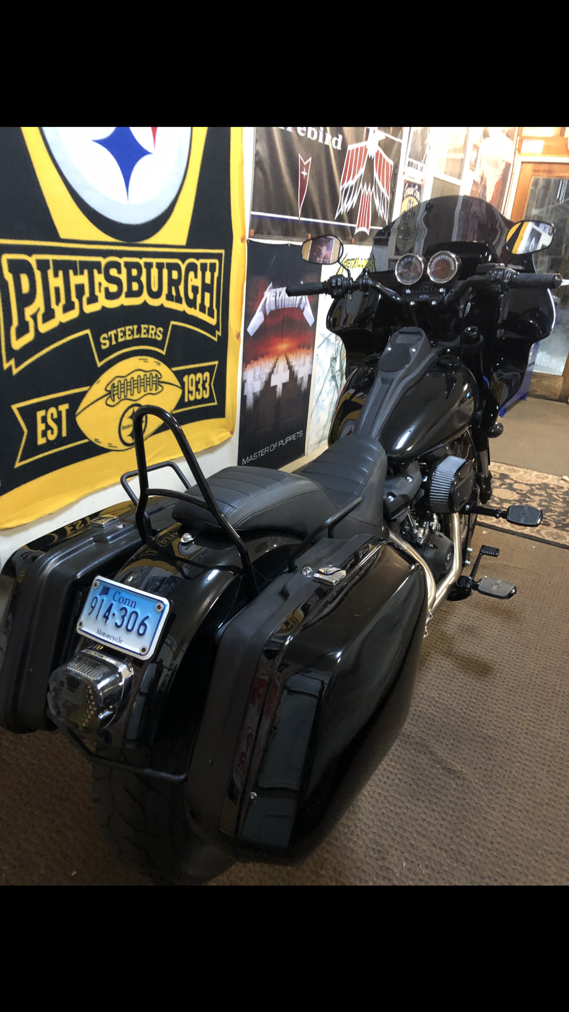

20-21 relocation duel gauges.
